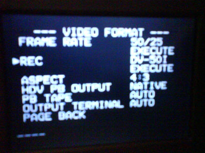

Michael you can shoot in PAL DV from a HD100u camera, trust me I know, this is how you do it.
1. Go into menu - Video format
2. Change frame rate to 50/25 click execute, this should restart your camera
3. Go back to Video format
4. Change REC to DV-50i or DV25p depending in what you want, and click execute.
Bang, there you have it, 50i DV in NTSC camera, PAL cameras can also switch to NTSC rates (60Hz)

Yes when you change over the rate to 50/25 in the record section you will get HDV-SD50p play around with REC til you get 50i, I have the the HD100u and it works for me.
If it doesn't work please reply.

Tim, this maybe the difference between the cameras in the US and the ones in Japan, they both play NTSC and I had thought there was no HD100j but there might just a camera, I am able to switch between NTSC and PAL DV modes.

Wow, so there is an actual "J" model, I seriously thought my camera was a "U" model even though the logos on my camera actually say "Victor" instead of JVC.
7.5%? whats that?
I have always had the ability to shoot in both full 60Hz and 50Hz modes, HD, SD and in DV. Recently I upgraded the firmware from work, but is exactly the same in function.
"eyes through a digital world"
