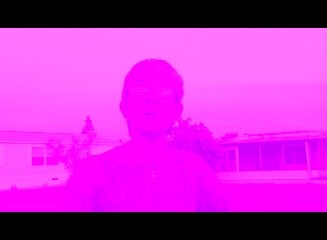

i was out practicing with the 110 and the DR
Shot little in HD 30P and switch to 24p press the trigger to record and nothing
happen (do i have to turn the Dr hd100 off when changing modes) look at Dr it was doing some thing strange so i turn it off
restarted it and shot some more clips.
the last clip look like i had the iris wide open in a bright lite yet in the LCD it looked fine check out pic
retested the camera and the Dr hd100 later and every thing look great
thank you
