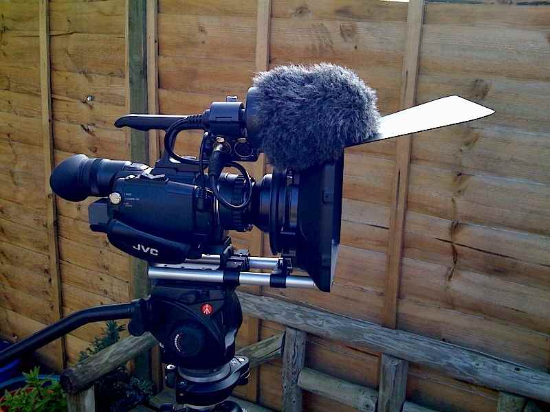

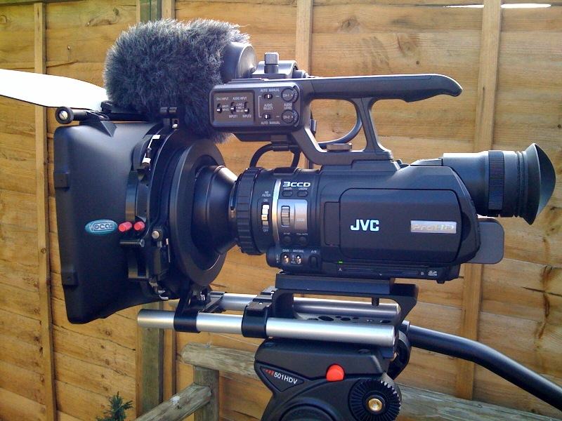

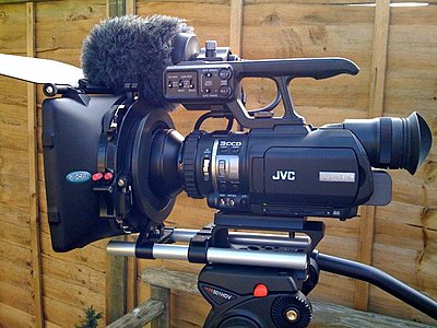

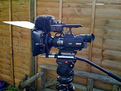

Day off today so spent it as any good filmmaker does messing about with gear. Nabbed a Vocas DV Matte Box II Wide Angle from eBay and it arrived this morning. The barsadapter mount it came with is for a Canon XL-H1 so after an hour eyeing it up and measuring, I chopped it in half and cobbled together a half-decent custom mount for the HM-100. Pics below. Needed to get the camera another centimetre higher, so was racking my brain sorting a jig out but couldn't find anything in the tool shed - then realised the Manfrotto 501 quick release plate I use is perfect size and could be modded...popped to camera shop and came away with another one. You can see it just below the camera and above the barsadapter mount. Below the mount sits another quick release plate for use on the tripod. The matte box takes 2 4X4 filters - one static and one rotating. The flag is a useful addition. I use a larger Vocas box on my DSR-450 and it's bulletproof. Really happy with this setup - should be perfect for mountain scenics next week. With the wide angle lens and all that metalwork attached it weighs in at over 5 1/2 lbs ! Still a lot easier to carry than the 22 lbs of the 450 with a Hytron 140 aboard, but this config with the HM-100 is strictly for tripod-mounted work. A smaller clamp-on hood and a radio-mic receiver will be used for run-n-gun. Thought you might like to see the pics.

I used the camera up a mountain this weekend, the Vocas box handled very well, and the Schneider Tru-pol polarizer was fine. I also used the camera with the 77mm rubber lens shade (wrapped some tape around the wide angle temporarily) and all well.

Yes, combined weight. Handheld, made my arm ache shooting for more than 10 mins, but do-able.
