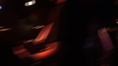

I have this problem as well, unfortunately discovered this on a paid gig. I usually shoot 60i but switched to 30p and 1/30 to match a locked off EX1, it was a musical performance so lighting was pretty low.
When I got home and looked at my footage I could not believe what I was seeing - anytime there's movement in the frame jagged lines appear. Footage is pretty much unusable and obviously the performance (2 hours) cannot be re-shot.
