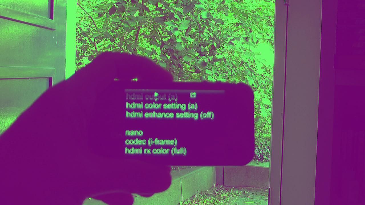

i tried to make a time lapse with hm100 and nanoflash.
i made a connection between the two devices through a HDMI-cable.
at the end of the day i discovered that the captured image was green-ish and purple-ish. today i did some 'reverse ingeneering' ;-) and discovered that the strange hdmi-colours are related to the 'HDMI COLOR SETTING' of the hm100.
when the setting is set to 'automatic (A)' there's a chance that i get a strange colored image.
when the setting is set to 'RGB' most of the time (not 100% shure) i get a normal colored image.
does anybody knows what's going on?

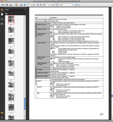

Have you had more time to investigate if this only occurs with the Automatic setting?
Say for instance if you power up the nanoFlash with the camera set to RGB then switch to Automatic do you receive the same result?
We suspect this may be happening if the camera is outputting YUV when the Automatic setting is selected.
Also as stated in the JVC Manual on page 63 which I have attached.

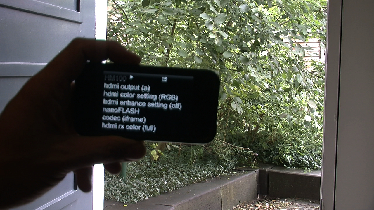

so i did another test today (powering on nanoFLASH first (HDMI-cable already connected), HM100 powered on next with HM100 color-setting @ RGB). This resulted in a crystal clear image.
http://www.dvinfo.net/forum/attachme...1&d=1314110236

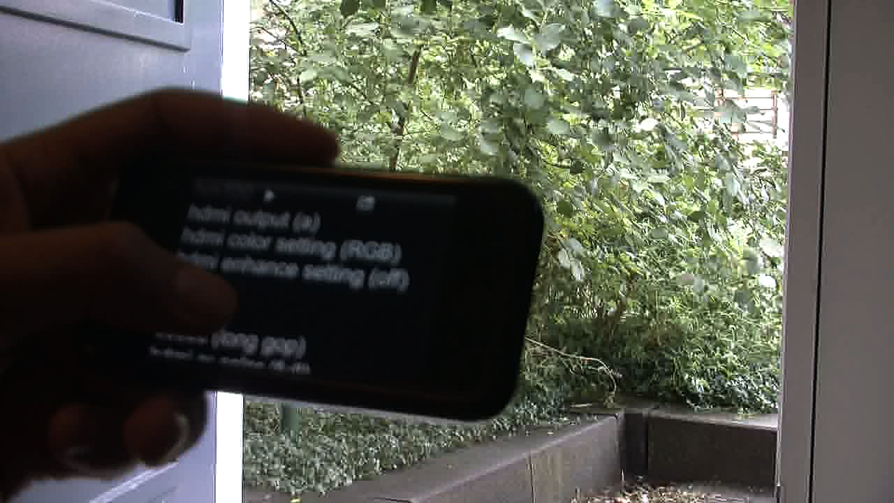

BTW: in time lapse mode: does the nanoFLASH automatically select the iFrame-setting? if not, does it explain the pixelated picture (seen in background) like this: http://www.dvinfo.net/forum/attachme...1&d=1314110236
