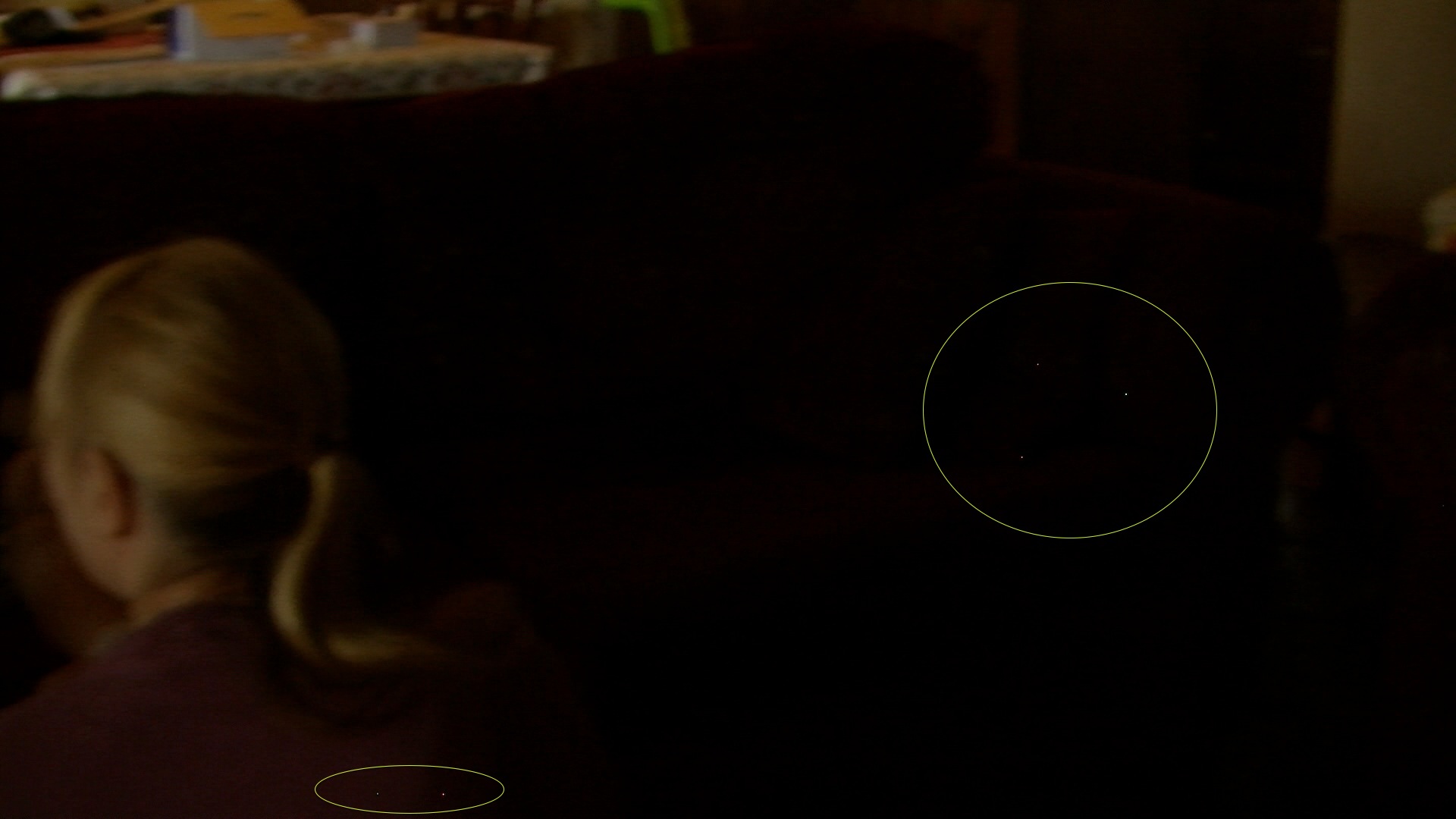

GY HM 100
Anyone know what this is- see pic.
Over the space of about an hour, these white dots appeared on the sensor (I presume),
they are on the LCD, external monitor and output to TV through HDMI, and worst of all, in the movie file.
Is there any easy fix?
Any advice appreciated.

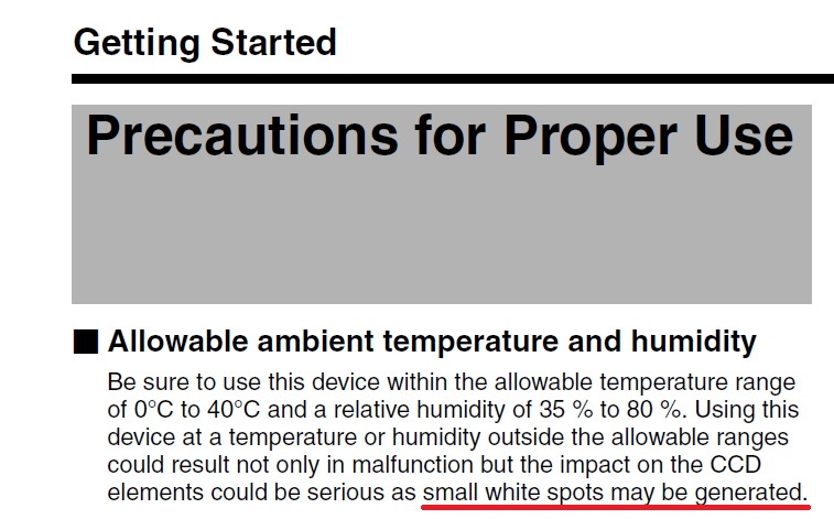

There's a note on page 8 in the owner's manual about using the camera outside its temp/humidity limits. Says the CCD can make white spots. Someone else reported the same thing on here a few years back, don't know if he got to the cause of it..
http://www.dvinfo.net/forum/jvc-gy-h...new-hm100.html

Those look like stuck pixels. I know on the HM700 there's a way to fix them, but I'm not sure if the same applies to the 100.

I own both a 700 and a 100. There is a way to fix dead pixels on the 700, not on the 100 but frankly these don't look like they're dead. It looks like the temp/humidity thing. I saw it once on my 100. Turned it off, let it acclimate a bit longer powered up and the white spots disappeared.
Might be dead pixels but the way to know is turn it off, let it acclimate and turn it on again. If they're gone great, if not, well you'd need to send it in.
Don

I have a lot of HM100 footage with a bad pixel so I created this plugin to quickly solve the problem. It basically averages the surrounding pixels and covers the bad one. Mac only.

I woke up this morning, read Dons reply, turned on cam and did a happy backflip. They were gone.
But, went and got the kids up while filming a short test (they love that) and after about 4min the spots came back, but not as bright.
Does this mean it is condensation?
If so, if i run the cam in the backyard for an hour in the sun, would that burn it off?
Really wanted to use this cam over this weekend for a job, if i cant sort it by lunchtime ill have to use another i guess.

Update, ran cam in warm sun for an hour. No change.
Had a thought, maybe going about this the wrong way, so...
Ran cam with 18dec of gain in dark cupboard for an hour. No change.
Checked firmware, there was an update. Updated, no change.

Found a workaround, If I add 6db of gain the dots disappear. Go figure.
Is there any problem with having 6db of gain and then adjusting iris and /or AE to suit?

It should be a simple remap of the pixels that's stuck/dead when its at the service center.

The dots came back, even with the gain.
Does anyone know where a person could download the software to carry out the pixel masking ?
I just cant afford to leave it in the shop for an indefinite amount of time.
