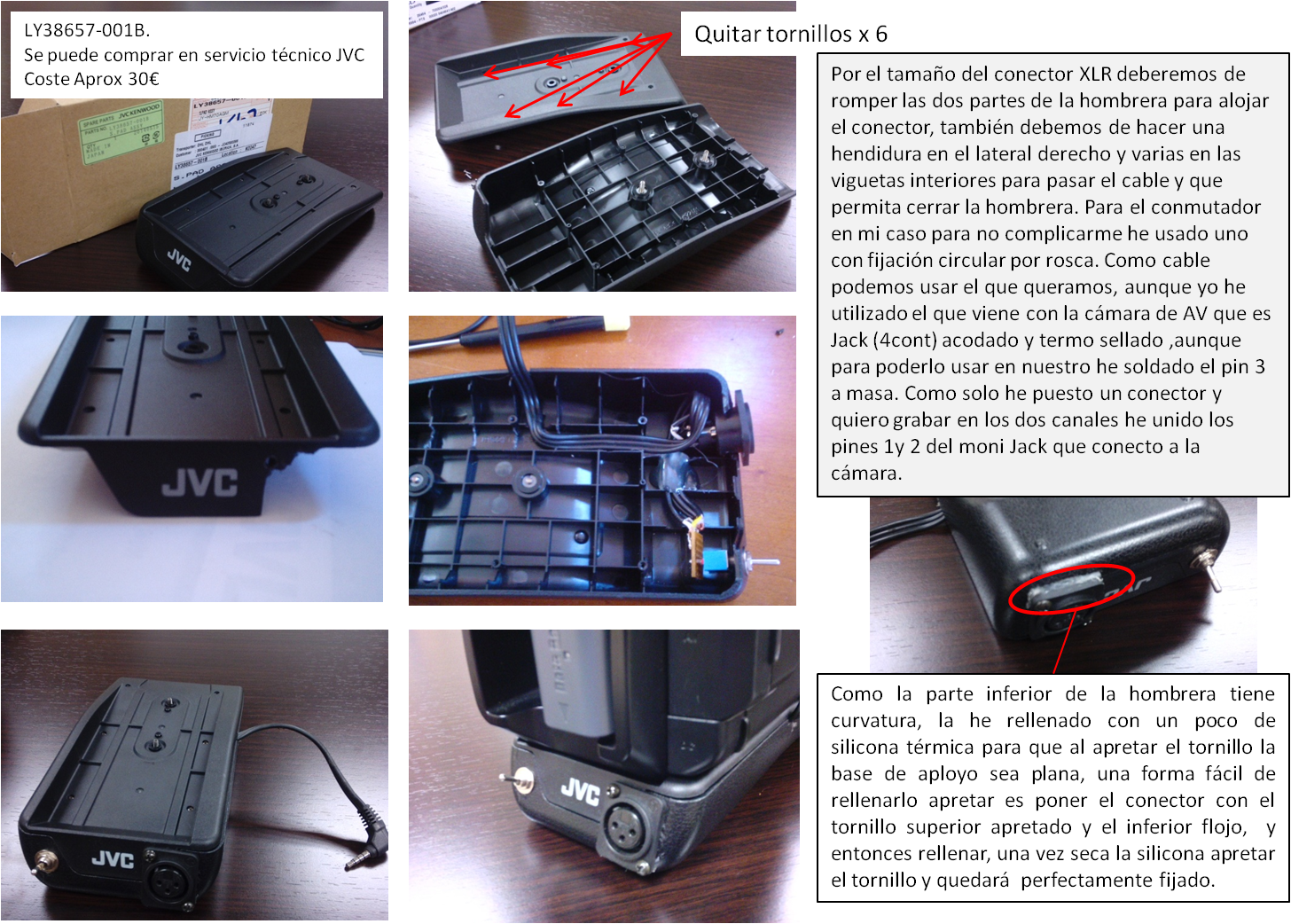

The HM70 is a little front-heavy for long takes. It needs a counter-weight. This was important to me because I'm not getting any younger and I had to take drastic measures.
the counter weight is just 1.2 lbs and I've decided to attach it to the back of the shoulder pad drilling it to accommodate a 1/4-20 screw and securing with a washer and a nut, leaving enough screw for the weight that comes with a female 1/4-20 thread.
http://i1234.photobucket.com/albums/...l.jpg~original
http://i1234.photobucket.com/albums/...pshhaicdxq.jpg
in order to drill the pad follow the instructions here:
http://1.bp.blogspot.com/-TtwNY56gh0...adware+mic.png
from the blog of Carlos Martínez Herrera
skip the part regarding the XLR mount obviously
with just 1 pound now it stays better on the shoulder not requiring too much from the left hand holding the hood or the lens.
this thing will void the warranty, unless you buy a second shoulder pad (available from JVC part# ly38657-001b and drill that one instead.
