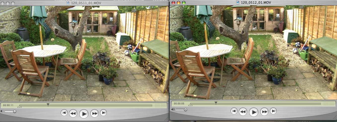

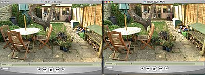

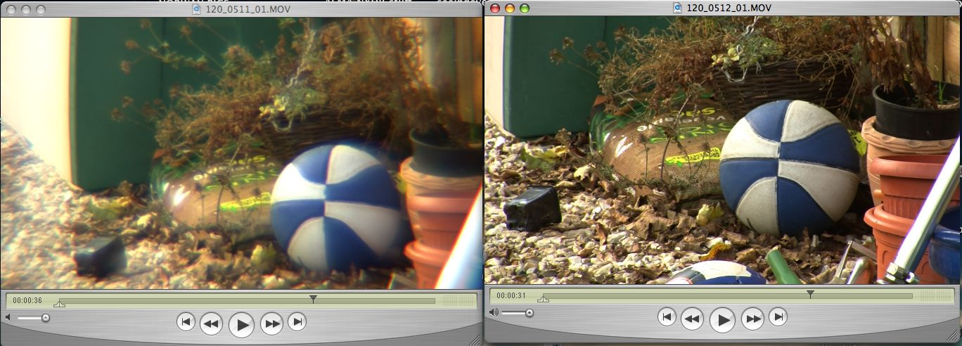

Originally Posted by Steve Cottrell View Post
Thanks.
I came across a mint Nikon WC-E68 so have nabbed that to try. If it performs better than the JVC, I will eekbay the JVC.
The Nikon WC-E68 is worse than the JVC adapter, and better than the JVC adapter.
Worse than because the CA at the end of the bottle is shocking. Better than because the size is nice, it's slightly wider than the JVC, and the build quality is excellent with no dust inside.
Sigh. Nikon on the left, JVC on the right.
I might send the JVC off to be disassembled and cleaned.

Agreed. Actually I'll keep the Nikon - it's tolerable when the camera is as wide as possible, and slightly wider (noticeably so) than the JVC. In fact used the Nikon today with the cam mounted on a car dash for interview with the driver (local news), worked a treat. I've had a quote of fifty quid to have the JVC adapter cleaned internally, which I would rather do than chance exchanging it for another with similar quality control problems - JVC go and kick some suppliers' butts! The JVC .7X is a good performer so hopefully when I get it back without the debris field on the rear of the front element - or the front of the rear element, which ever way round it is - I'll report back.

Does anyone else have this same focus problem shown by Steve (above)?

Re: .7x Wide-Angle Converter from 16x9 for HM100 - Anyone used?
Hi Kirsty
I have the Nikon WC-E68 and it works well. There is a slight amount of smearing near the outer edges of the frame, and it doesn't feature complete zoom through, but it is shorter, lighter and less expensive than the one JVC offers (which optically isn't much or any better).
I think I've posted on other threads here about it.
