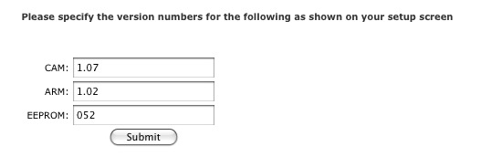

I also can't get it to work on the web page. I enter my camera info as follows:
But also get the message that it can't figure out my software version. Bummer, not very confidence inspiring JVC! If my firmware is already up to date, it should tell me that.

The same message from JVC-site:
We are unable to determine current version of software you have. Click here to go back and try again.
I see I've got the same as American HM700U, my
Version was 0106, 0106, 0200, 0100, 0103, 0101, 0100, 0102
Eric Deyerler is offline   Reply With Quote
I have the same numbers, and as the site suggests, I left out the decimal point... those this didn't help.
Old August 20th, 2009, 09:29 AM   #29
JVC
Posts: 13
Please try again. This morning we loaded in additional versions of the firmware, so the system should now recognize most cameras.

Old August 20th, 2009, 09:52 AM   #30
Location: France (Normandy)
Posts: 42
it's working now David
thanks
