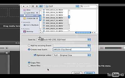

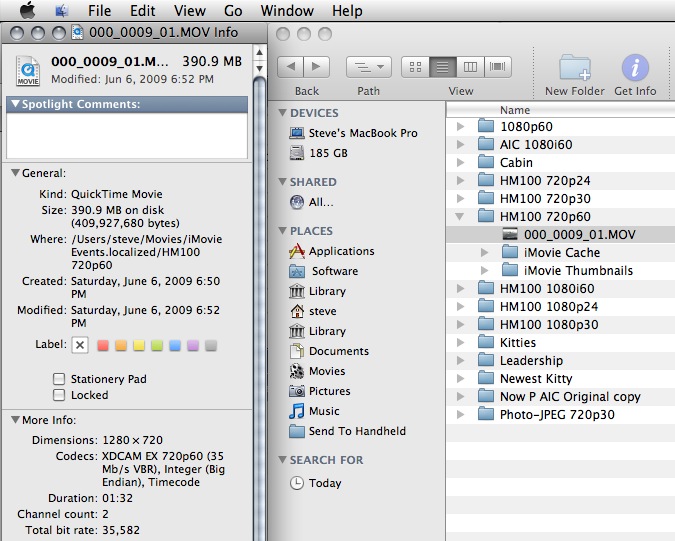

Tim, in the brief section on iMovie in your Tutorial ---you say XDCAM EX is always transcoded to AIC. That's only true if you click Optimize. I'm using iMovie with XDCAM EX and as you can see the Event has XDCAM EX clips. (Although I have FCS2 installed.)
Snow Leopard and ProHD Clip Manager not working properly-picture-2.jpg   Snow Leopard and ProHD Clip Manager not working properly-picture-3.jpg
