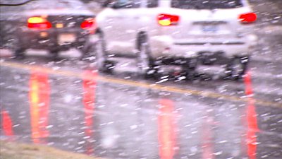

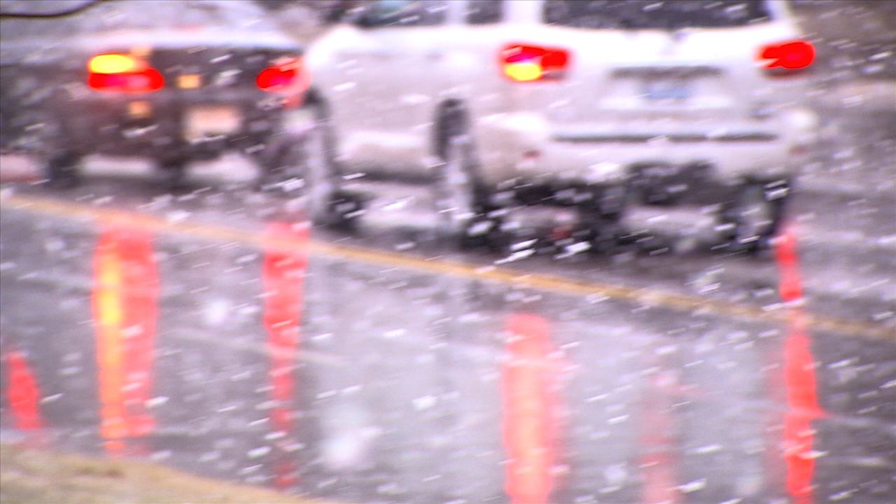

I’m attaching a still image (at the bottom of the page) that shows how oversaturated reds are with my “DSC Chart” setting. Sorry for the poor composition of the shot, but it was a perfect frame grab to show just how saturated and bizarre reds look with this setting.

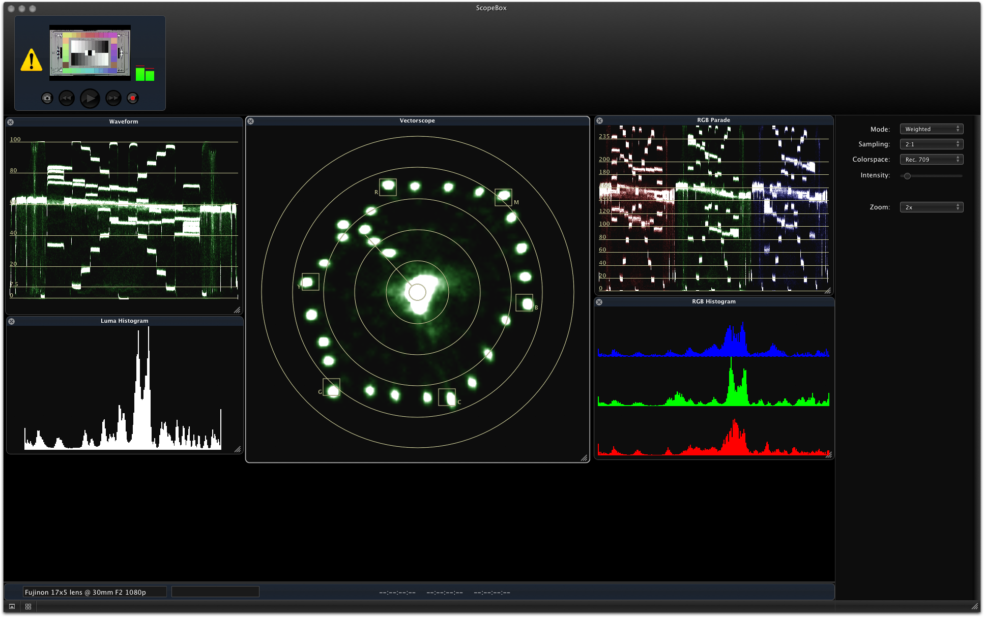

When you calibrated to the DSC chart did you set your vectorscope gain to 2X ? The charts are now all calibrated to 2X gain. They used to be set for 1.875X but all current models (since 2008 I think) are 2X.
If you didn't do this then your saturation will be double what it should be because you are taking color swatches that should be only be 50% saturated and you're bringing the saturation up to the level of SMPTE color bars. This is an important factor I believe was overlooked when the original "TrueColor" setting was created and the probable reason it is so oversaturated as well. Blame me for suggesting the name "truecolor." I didn't learn until I started working with DSC myself that the results may have been flawed. However, the truecolor settings seem to be popular with the wedding video guys because they make the bouquets "pop" and they don't have to deal with broadcast standards.
I've attached a frame grab from my DSC CDM28 calibration using Scopebox 2. They added 1.875X and 2X vectorscope gain specifically for DSC CDM charts. You'll see it isn't perfect but it is as close as I could get it.
I've also attached my DSC calibrated setting for the Fujinon 17x5 lens as a CMP file that can be dropped into the PICTURE folder on a SDHC card and loaded by the camera.
As for the comments on detail... If you are shooting for direct broadcast without any chance to grade or adjust edge enhancement then by all means shoot with detail on NORMAL. If you are shooting for a cinematic look, possibly for the big screen, then shoot with detail set to MIN and add the appropriate amount of edge enhancement in post. Different masters (DCP, HD, SD) will require different amounts.

Todd - did you notice the oversaturated reds in other shots? I only ask because a backlit tailight is a particularly tough test for a CCD based camera. I'd be interested to know if you noticed the same over saturation on a bright daylight balance.

There were other things that looked insanely red...a dog collar, painted letters on a white truck. So I've set my color matrix back to JVC default and I'm satisfied. I'm using Cinema Gamma but with a Standard Color Matrix with saturation boosted up to 2. That seems to look good. I've also dialed down the green gamma a bit.
