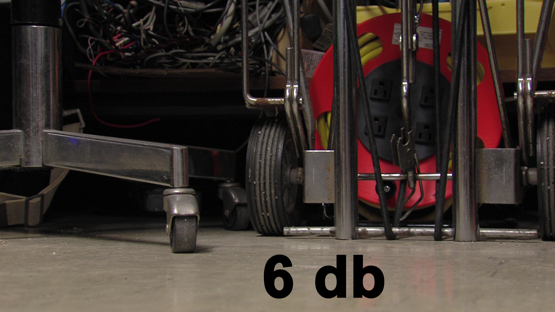

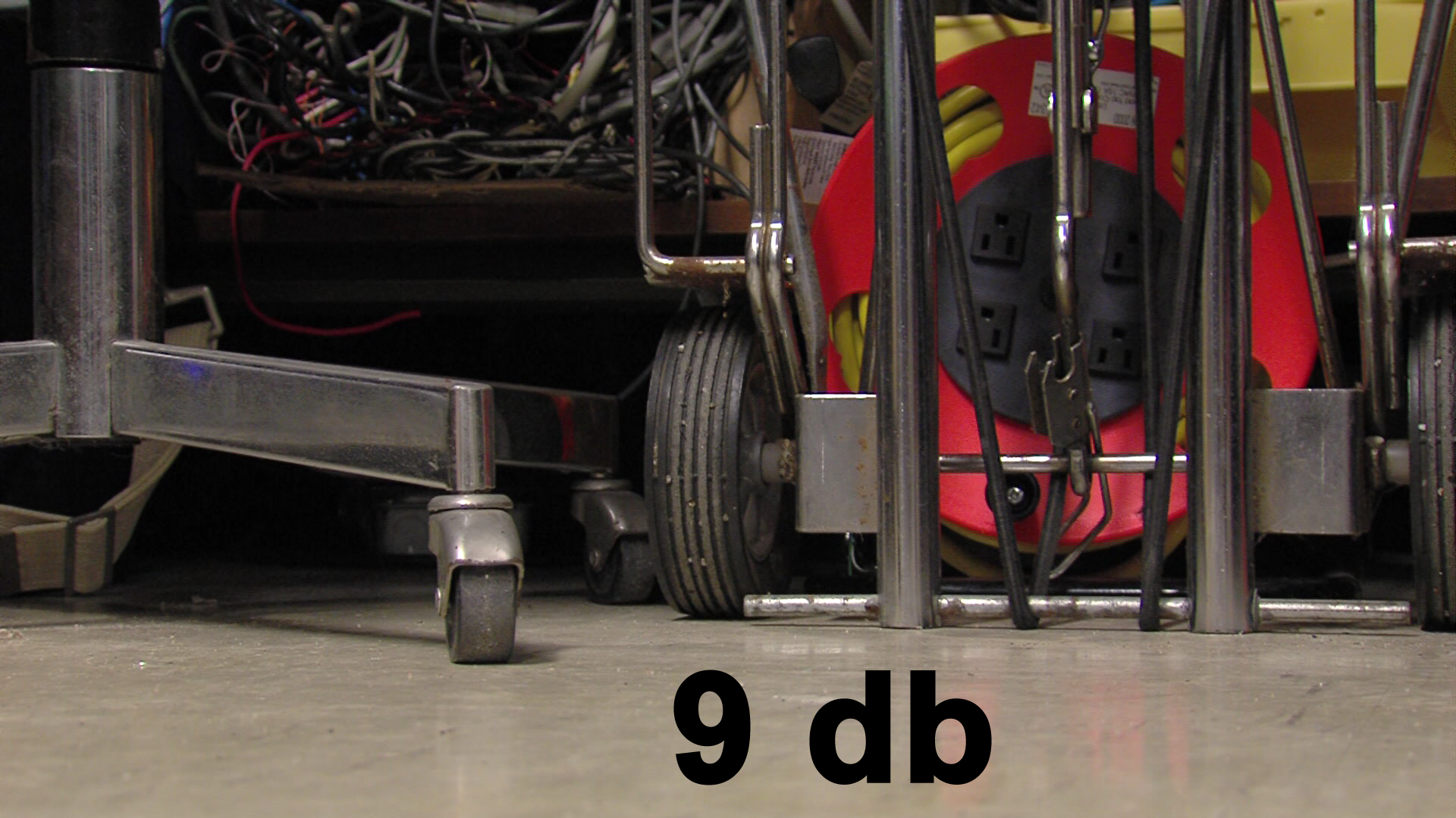

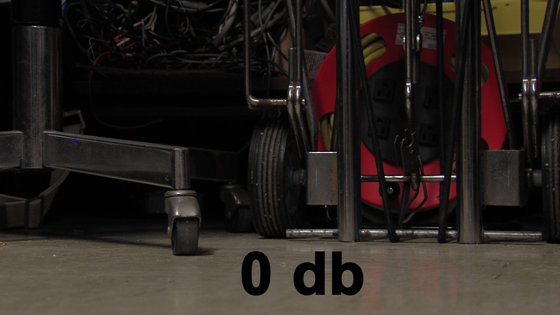

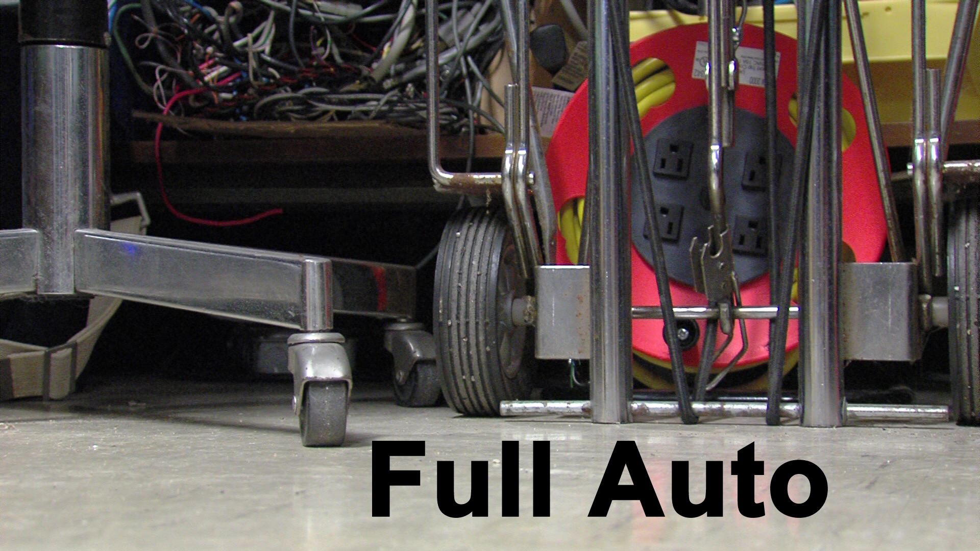

Noa, it's not great shooting but here are a few quick frame grabs from my HM700 (with the Canon lens you mentioned) for you.
Let me know if you would like to see something else.

Thx Steven for your answer, that the jvc is not a 5d in low light I expected :) but that is not what I am looking for in a real videocamera, I do have a 550d for very dark receptions where I don't have the possibility to use a videolight but I need a camera that will match de dslr colors better as well and that I can use as main cam in good light conditions but also in a bit darker places. When it gets too dark the dslr has to take over anyway. It's good to hear though that up to 9db is clean enough, for me was important that it performs better then my xh-a1 and with a max and clean +9db gain I can live.
Also thx for the photo's Mike, that's great to see some real live results. +9db looks clean indeed, I guess the auto gain is somewhere around 12-15db?

Noa, full auto is +18.
BTW, the camera has a 3-position gain switch that can be set to anything you want.
I believe that default for positions 2 and 3 was +6 and +9.
I changed it to +3 and +6 as I rarely encounter low light situations in my work.
