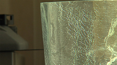

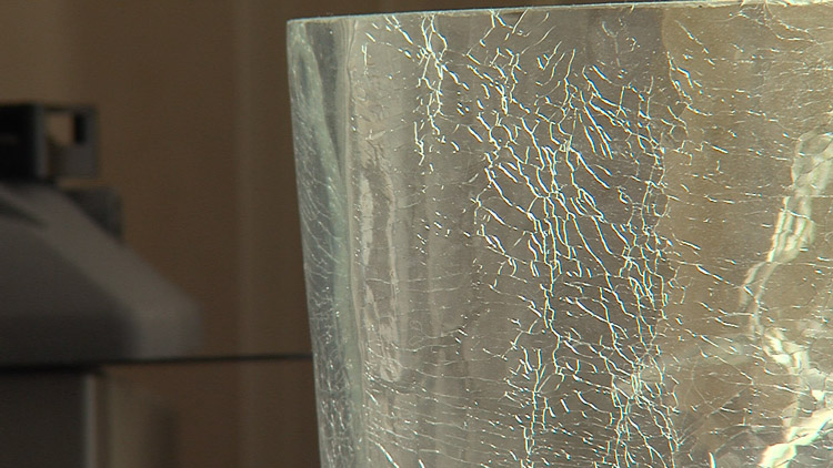

Maybe I'm missing something, but I can't use the preset filter on the HM700.
The preset 3200K is to blue-ish and the 5600k filter far to yellow. Normally when I shoot outside I could use the 5600K(nd) filter and the white balance would be perfect. But with the HM700 I don't seem to get an accurate 5600K preset filter.
To demonstrate I decided to do a AWB outside and stored it on the 'B' switch. According to the camera the AWB was 5600K. Just like the preset filter.
Both screenshots are made indoor with 5600K, but the more green/yellow grab is made with the preset filter of the camera. Is there a way to change the color tint of just the preset from the camera, without changing the color tint of the AWB as well?

Yes, I've noticed something like this too, not just outside, but in the studio under various conditions.
But I don't think it's exactly a problem with the preset values... rather it is that the white-balance feature does not accurately report the detected K value to the camera operator. I think it rounds to the nearest value, but not in increments of 100, more like 500 (3200, 3700, 4200, etc.), and there may be more to it than a liner 3K to 8K scale of "white".
But I've noticed (just a couple of weeks ago, in fact) that two different WB settings (on A and B) reporting as "3700K" gave noticeably different results in the viewfinder.
An important lesson from this is to take white balance readings frequently... even if you "know from experience" that you're in a 5600K environment, just because the camera says "5600K" on the viewfinder, doesn't mean it's actually attuned to your current lighting setup.
Oh, and as a feature request I would really love to be able to arbitrarily specify my own white balance value... Why just the two preset values? The camera has up/down buttons and menus, for goodness sake, let us dial in a number. That way, special effects and minor tweaks to the WB detection can be accomplished far more easily.

I've also noticed that the 5600K preset is not accurate, it looks a little green to me. The 3200K preset seems pretty good to my eye, but I'd like to verify it with a vector scope.

i discovered the same problem today (hm700e).
preset 5600k is greenish, white balance @ 5600k looks much more 'normal'.
i made the white balance in big building with a lot of glass. and the glass has a very light greenish tint.
what do you think; could it be that greenish glass compentates the greenish preset white?

but don't you think it's strange that a 5600k-preset is more green than a manually made white balance @ 5600k?
i wonder if there's a 'deeper service menu' at the hm700 where the 5600k-preset kan be tweaked in terms of lowering the green value.

I'm glad to see that I'm not the only one with this problem. Must be something with the camera. I have the Fujinon 13x wide lens on the camera and thought it might had something to do with using a different lens then the 14x Canon.
Ralph, I did my white balance outside. Did you do the white balance with a card? Sometimes the white balance is a bit off and luckily you can see this before recording and do a second white balance. But I agree with everyone else, it's better to do a manually white balance if possible. The FAW is pretty good too I must say, but not preferable.

mike i understand what you're saying, but how do you explain the greenish picture when you keep in mind that there are two different pictures made at the same color temperature (one at 5600k preset and one at 5600k manual white balance)?
does it mean that the preset is not comparable with reality?
