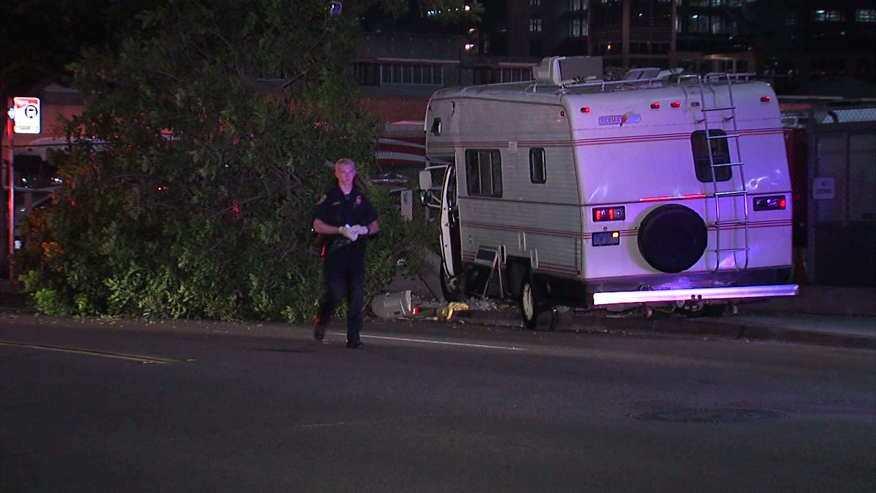

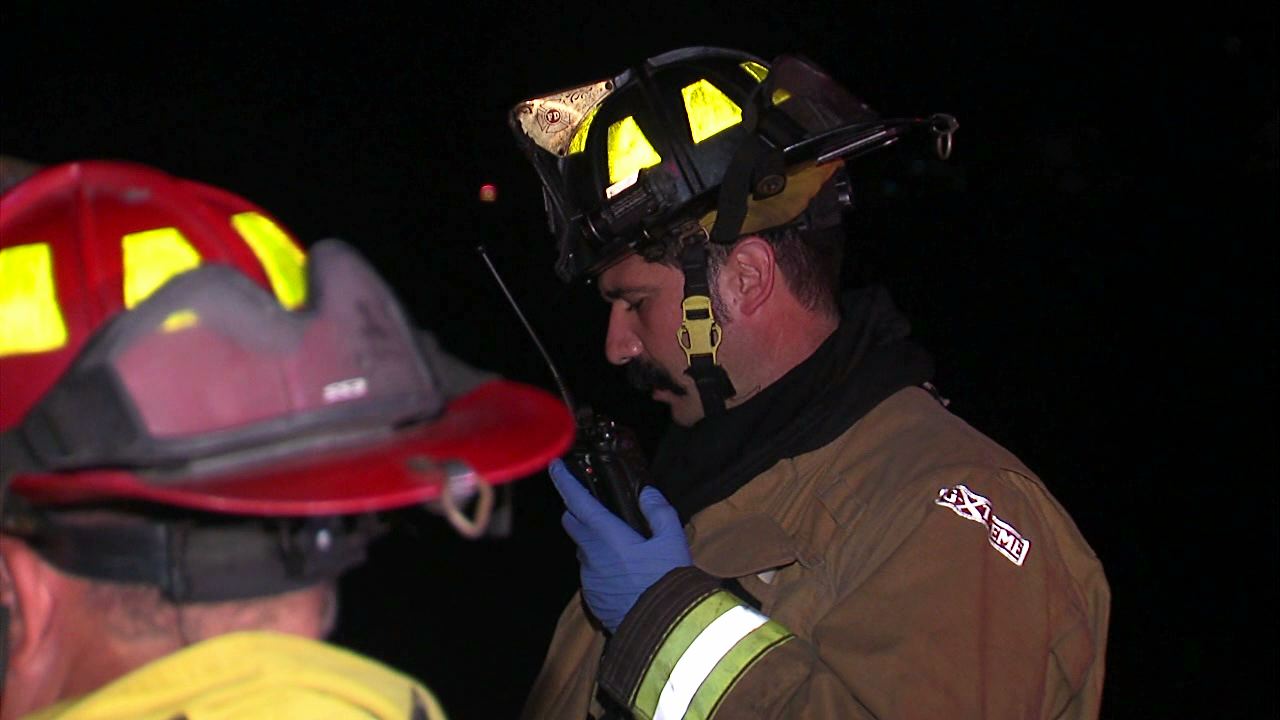

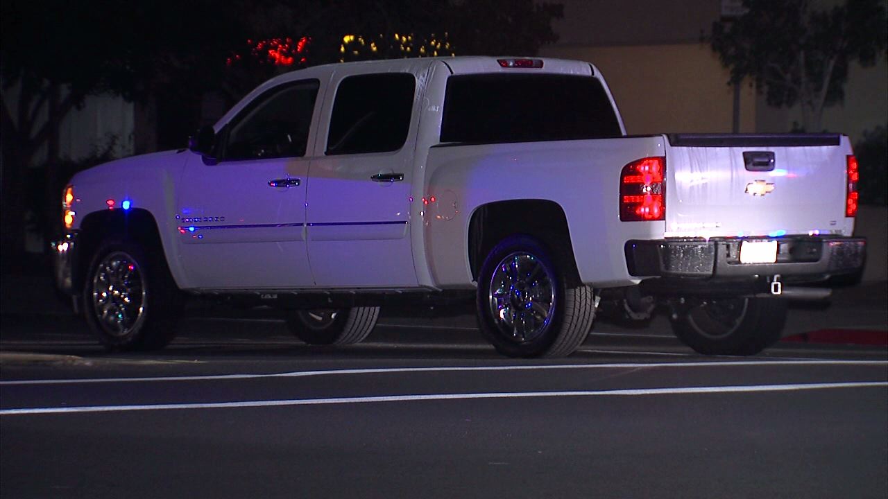

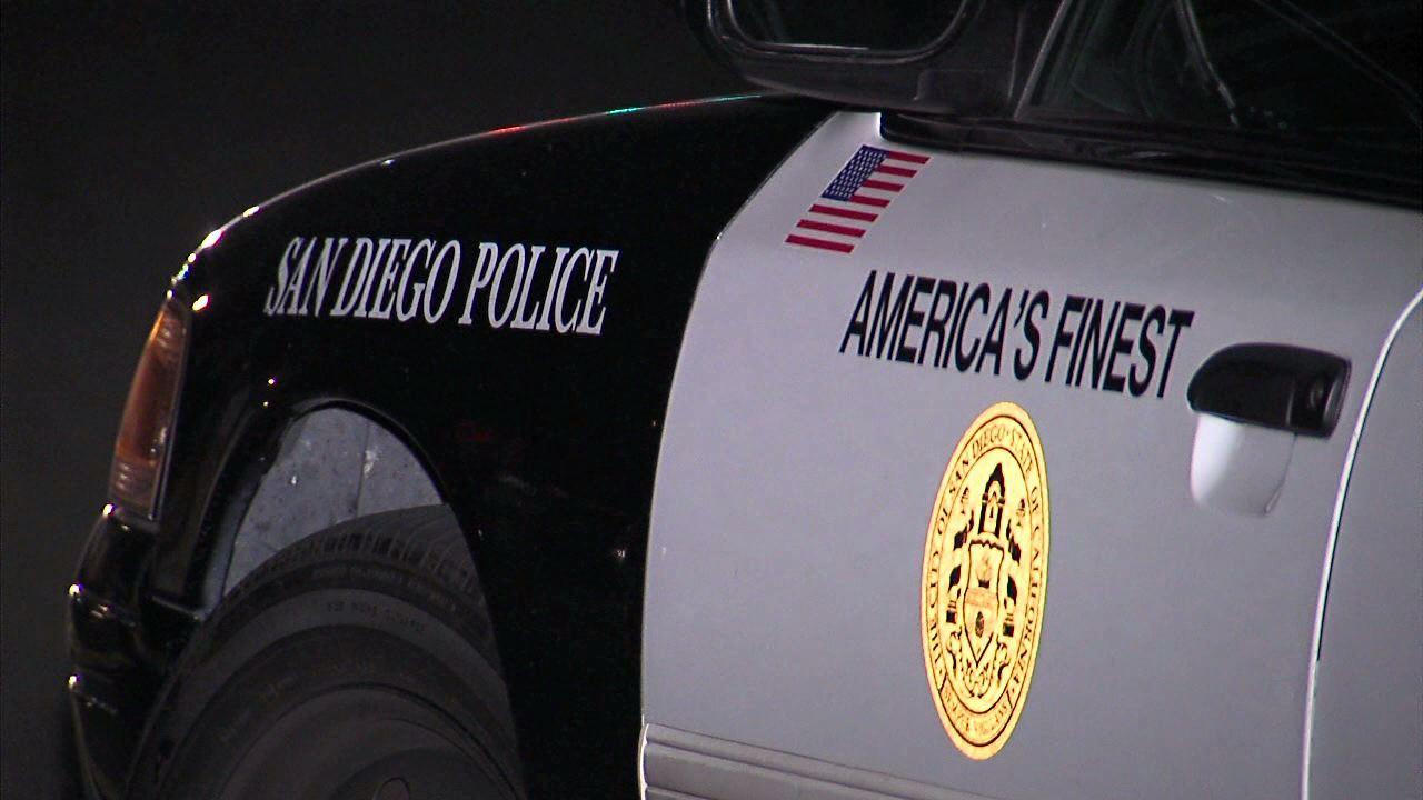

Try these, got most of the color settings from some previous posts. This is a fairly straight to BROADCAST configuration, just pull the whites to 100% and your good to go. Trying to get the camera (790) on a scope to get everything perfected, but I will post a YouTube clip soon of footage using these settings. For now, here are a couple of selected frame grabs.
Paul
CAMERA PROCESS MENU
DETAIL: 1
DETAIL ADJUST-
V/H BALANCE H-MAX
H FREQUENCY HIGH
V FREQUENCY HIGH
MASTER BLACK: NORMAL
BLACK TOE: NORMAL
KNEE: MANUAL
LEVEL: 70%
WHITE CLIP: 108%
GAMMA: STANDARD
MASTER LEVEL NORMAL
R LEVEL: NORMAL
G LEVEL: -2
B LEVEL: -1
WHITE BALNCE-
WHITE PAINT R: NORMAL
WHITE PAINT B: NORMAL
COLOR MATRIX: STANDARD
ADJUST-
R ROTATION: 1
G ROTATION: 2
B ROTATION: NORMAL
COLOR GAIN: 1
DNR: OFF
HM790 scene / picture files-youtube-stills.jpeg   HM790 scene / picture files-youtube-stills-1.jpeg
HM790 scene / picture files-youtube-stills-2.jpeg   HM790 scene / picture files-youtube-stills-3.jpeg
