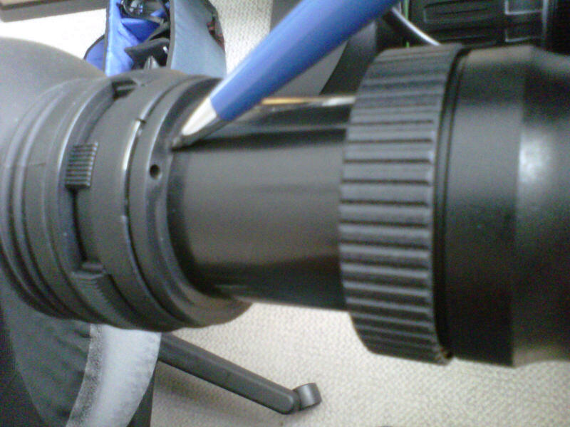

Hi Don, my 700 had the same film, and I figured out how to take the diopter off and clean it. Extend the diopter and flip the viewfinder over, on the bottom of the focus adjustment ring you'll see a small hole(see picture), insert something like a nail punch or tiny screwdriver to push the release button and turn the diopter counter clockwise to release it. Now you can clean both sides of the diopter. Be careful, the lens is made of plastic as far as I can tell.

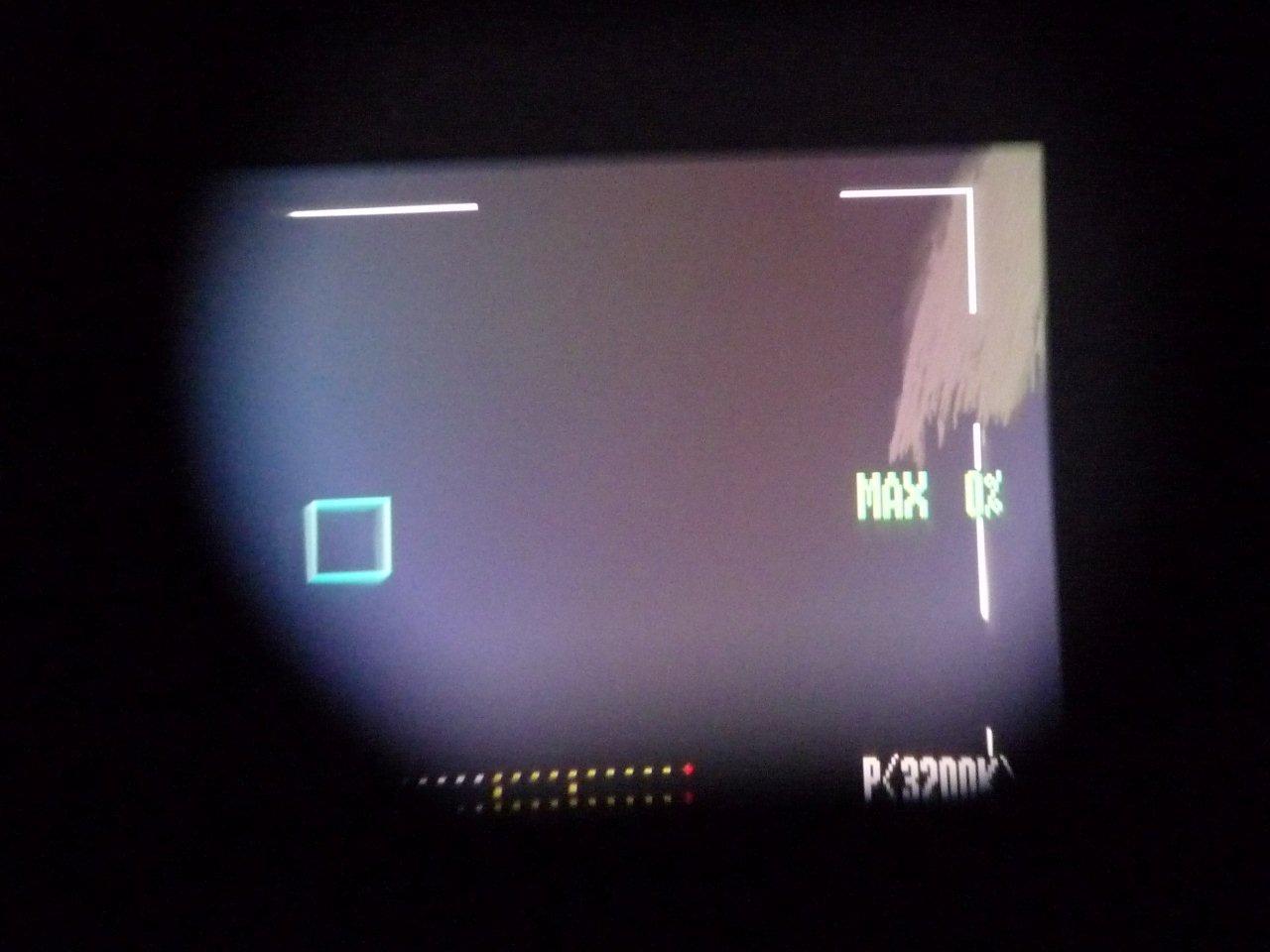

Don, another issue I had(twice) with my viewfinder was more serious. On the LCOS chip itself a layer(silicon?) began to seperate from the chip at the corner. This happened twice! Fortunately it was covered under warranty. The seperation seemed to occur after using the camera out in the cold...which makes me nervous now.
Can you take a picture of what you're seeing?

Here is a picture of my vf issue from a couple of years ago. The LCOS chip assembly had to be replaced.

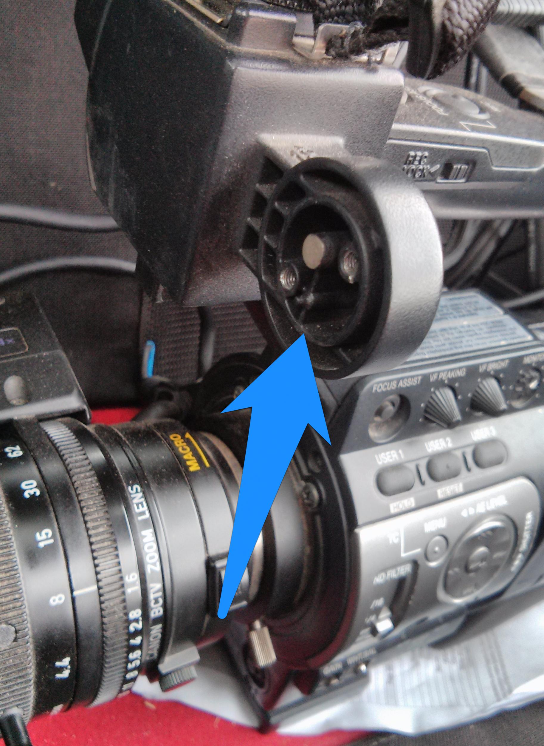

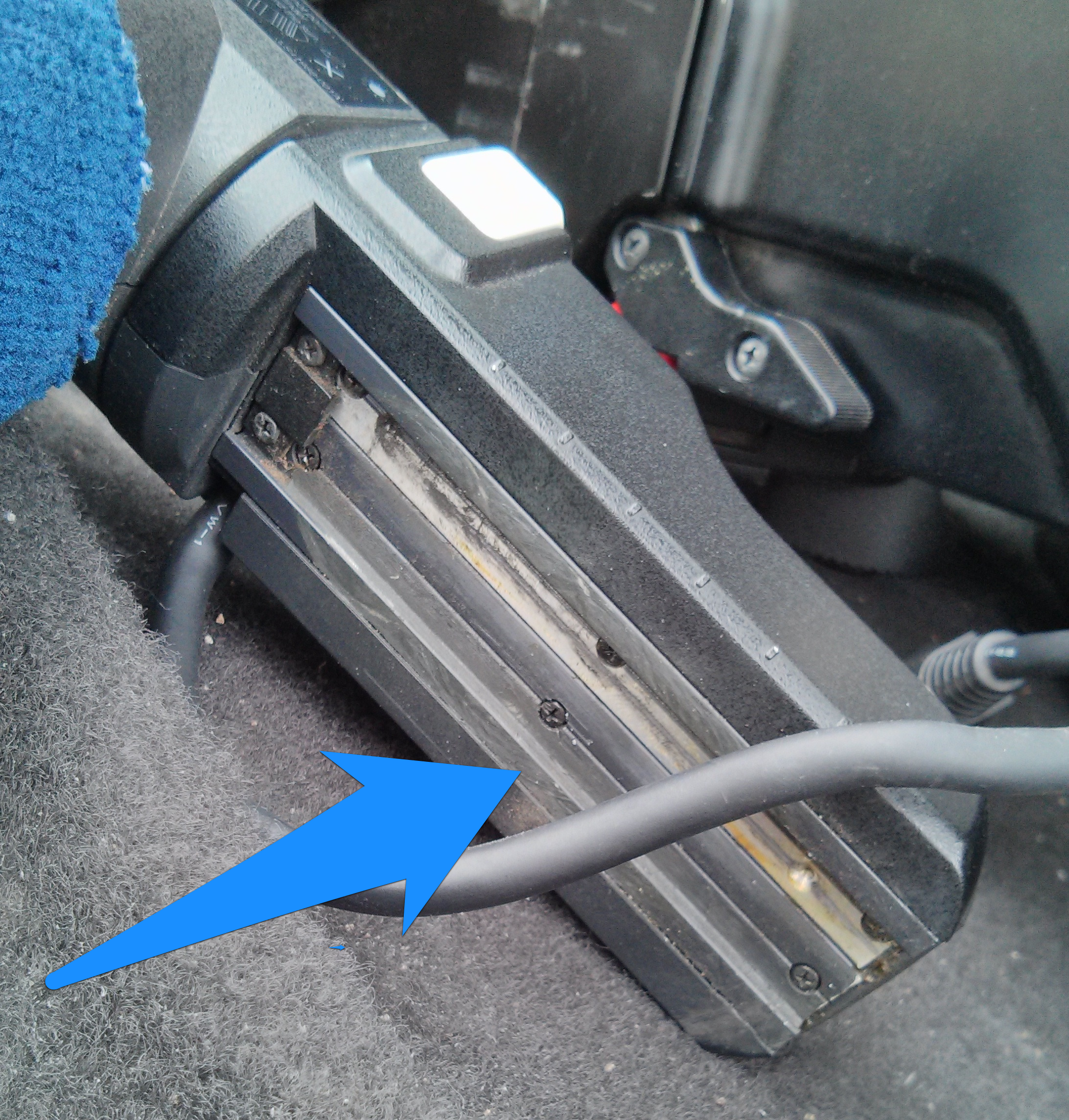

I know this may be a bot of topic bit still has to do with the VF, except that on a 710. Does anyone where i can get a replacement assembly for Slide Lock Ring?
Mine seems to have fallen off completely off while on a outdoor shoot and well all I have now is a viewfinder but no way to attach it with...

Attached are pictures so you can have an idea of what I'm missing. Basically it's the entire assembly that attaches the viewfinder to the camera body.
I tried looking at the manuals but JVC only refers to it as the "Slide Lock Ring" and it doesn't go into detail about that part. Already sent them an email and will try to contact the sales rep that deals with my TV Station to see if he can help me out...
