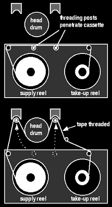

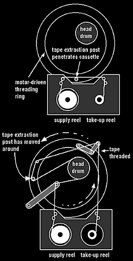

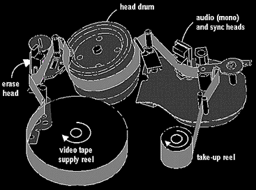

Bruce, then what you're saying is that miniDV tape isn't threaded the same way, for example... such as 3/4, betaSP, VHS, etc? What am I missing here?
The first time I saw how 3/4 loads & threads was way back in the day with a 3/4 machine where I worked that we would always have to take the top cover off (for whatever finicky reason I can't recall that machine had). When a tape was inserted, the tape is pulled forward by retractable guides and rests around the helical head drum. VHS and beta would thread the same way and I don't see how miniDV would be any different. Actually I don't see how there's any way a cassette based tape could be threaded with the opposite/underside (non-shiny side) of the tape coming in contact with heads.
I didn't mean to guide this thread to another level but I do think it's necessary for the sake of 'where' splicing tape should go.
I searched and found a few diagrams to more demonstrate what I was trying to say.

If you look at the first diagram above you can easily see that as the tape comes off the supply reel and goes around the head drum, the inside surface is what comes into contact with that head drum. It is that inside surface that is the "dull" or "matte" side of the tape, the other side that does not come into contact with the drum surface is shiny.
That is the backing. The reason the "dull" side is "dull" is because that is the oxide layer.

Actually Bill is right. The base side is the flat side. I must have been in a film flashback there or something. Also, I've seen splices made on both sided and they run through most decks OK, at least once, so it's probably not a big deal if you do the splice nice and smooth and make sure the scotch tape is even and not lumpy. If you look at the bottom drawing it's a little more clear.
