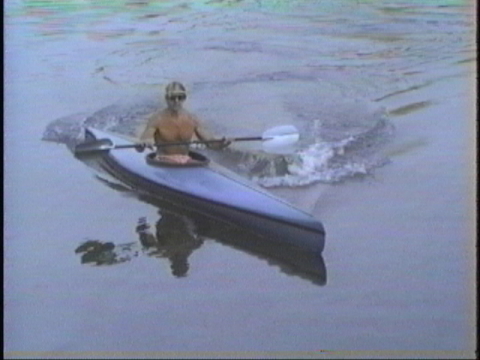

Kevin, I haven't had a bit of trouble with this VCR, after 3.5 years of service. I just excavated a long-lost S-VHS tape from my attic, that had been suffering from 19 years of extreme hot and cold temperatures. This had important footage and the HR-DVS3U played it back nicely and internally re-recorded it on DV tape. The TBC on the analog playback really made the video quality look good-----much better than it did when first played in 1988 on an older VCR. If anyone has an archive with old VHS and S-VHS tapes, this would be a great deck to use for conversion to DV or for sending to a DVD recorder. With the timecode it added, I then was able to do an upload over FireWire to a harddrive and the DVDs I've made from it, don't show much sign of its ordeals. This is not a simple, consumer VCR, as it has many complex features. Fortunately, it has a good manual and you need to read the details of each procedure. I might re-state that I can exchange recorded tapes back and forth that were made on my VX2100 and GV-D1000 and the JVC, with no incompatibility, on both SP and LP speeds. The HR-DVS3U doesn't play back DVCAM tapes, but you could send a DVCAM output into it over FireWire and it would re-record it in DV. Good luck if you decide to pick up one.
Here's a vid-cap from the old S-VHS tape I played on the HR-DVS3U. The footage came from an 8mm camcorder and was 2nd-gen. on the S-VHS tape. This used a composite transfer, with no TBC. After I converted it to DV in the JVC deck, I put the tape into the VX2100 camcorder and captured the still as a J-PEG onto a MemoryStick. Then, I used Sony's Picture Motion Browser to reduce it to 480 X 360, a size that minimizes this string of disadvantages it suffered.

My policy about head-cleaning, is to never do it until a recorder shows signs of needing it. So far, this one hasn't. Besides, this model and many others by JVC have built-in head-cleaners. Everytime you load a cassette, the head-cleaner brushes against the head-drum for a moment. It doesn't clean the whole tape pathway, so any cleaning that would be needed, should be for doing that, plus lubrication. If cassettes are slow to load or refuse to do so, the tape-threading mechanism might need maintenance. I've had to have no repairs done to it.
I've never bought any used equipment, as I prefer to get it when it's new and unabused. Then, I take good care of it and never allow anything to be put into it, if I don't know everywhere it's been. I keep a VCR of ill-repute on hand, just to play cassettes of dubious virtue. I hate to say it, but if I received a DV cassette from an outside source, it would go into the JVC, to spare any risk to my Sony GV-D1000. The JVC is its designated cut-bear, as I think its sturdy tape mechanism may be better able to withstand a bad tape. Now, someone may tell me that all DV tape drives are made by Sony and there's no difference in them. If I had a pro model Sony DVCAM deck, I'd probably get the JVC pro version of the HR-DVS3U, that will play DVCAM recordings, as a companion for it.
