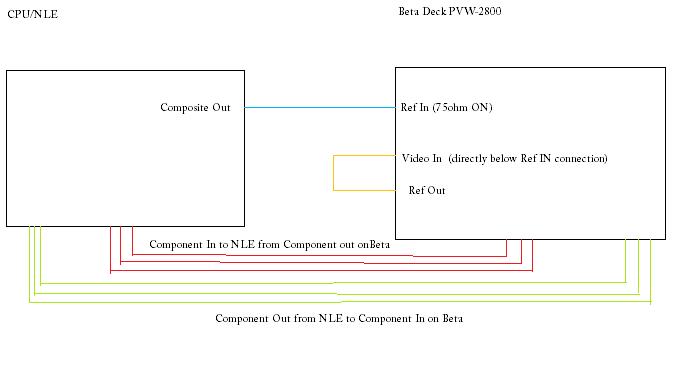

Ok, So I had the chance to look it over again. I think that I am already doing what you had said to do. Since I am unfamiliar with this beta deck stuff, I drew up a diagram. Am I doing anything wrong?

First, to see if there is another problem, try using the composite input on the deck to see if you are actually sync'ing.
As well, the jog/shuttle panel lifts up and you SHOULD have some switches underneath on the VTR itself governing Genlock - it's been a while since I've been in front of a 2800 so my apologies, I'm doing this from memory. It should be Internal or External if memory serves. Try each. And try unplugging and replugging the reference BNC each time to see if it "snaps" into sync.
