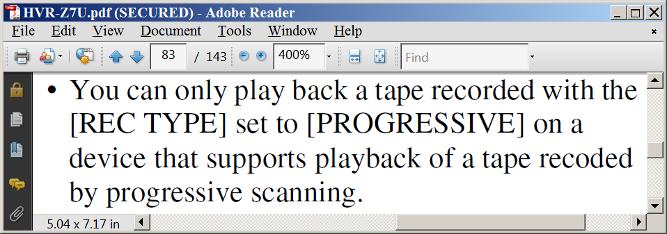

The A1 doesn't do 30p. You need a playback device that does.
From the Z7 Manual, page 83:

Just to clarify for Bruno: While the A1U has a 30p mode, that is actually only "mock-30p" rather than true 30p. The A1U records 60i and uses firmware to generate a 30p output from the firewire port. The A1U cannot play tapes with true 30p recorded on them. The Z7 can record and play both the mock 30p and true 30p. If the Z7 recorded in true 30p, the A1U cannot play it back.
You need to use that Z7 to feed the footage to your computer.

And to further clarify, if you record "fake" 30p in the Z7 -- that is, 30p over 60i -- it'll play back just fine on the A1. You would set REC TYPE to INTERLACE but SCAN TYPE to 30.
Again, page 83.
