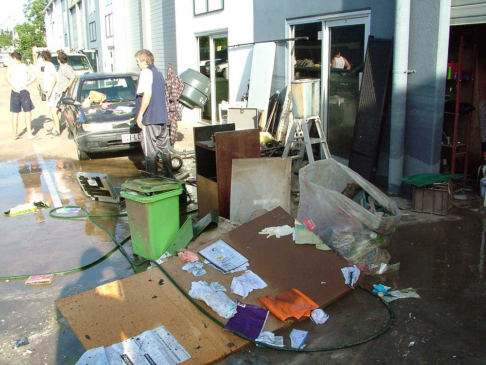

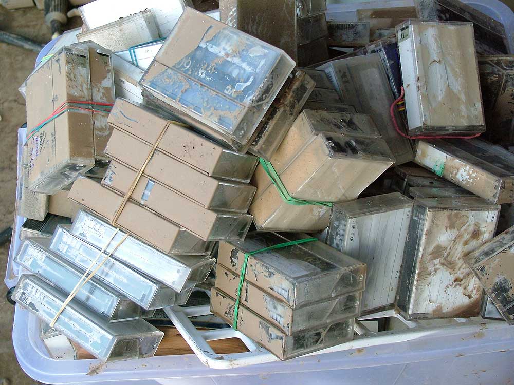

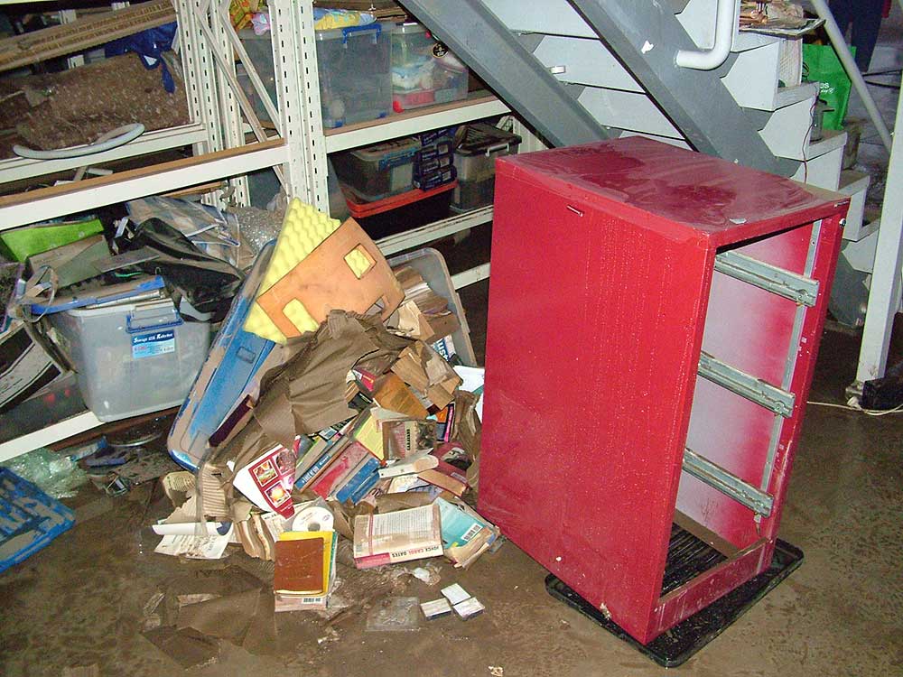

Actually the good news is that the tapes aren't mine. :-) The bad news is that the filing cabinet, audio mixer and Nakamichi 582 professional cassette deck were.
As far as we can tell, the 1 inch documentary master wasn't in the stuff that got wet.
Some pics attached to help visualise the scene.
Andrew

Sadly those are DV tapes and some are covered in brown silt, funny how some are not .. maybe the owner just threw them all in together in that drawer, after the water receded.
Hopefully they've all been captured to (dry) hard drives and the programs completed.
The DV cases would have kept some mud out, if he wants to keep them, just take the tapes out and let them dry out in the hot Qld sun. Turn them over every hour or so .. don't bake them tho. When they are thought to have dried out, wipe any silt off and open one up by lifting the front cover, see if the tape is OK inside. Good luck. Open up the Nakamichi and wipe the silt off, be careful putting power on it.
This reinforces the notion to keep all your tapes in resealable waterproof plastic fridge containers with some fresh silicagel. mmm maybe they would have floated off.
Andrew, I know that doesn't help the owner, please pass our condolences and wish them all the best, and props to you and all the others for helping out up there.
