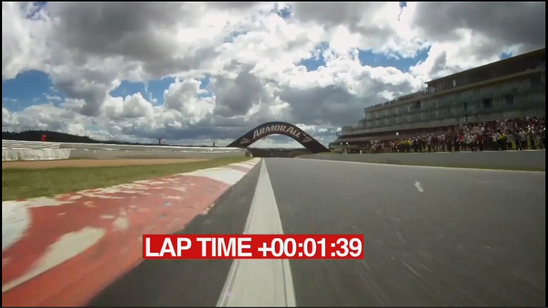

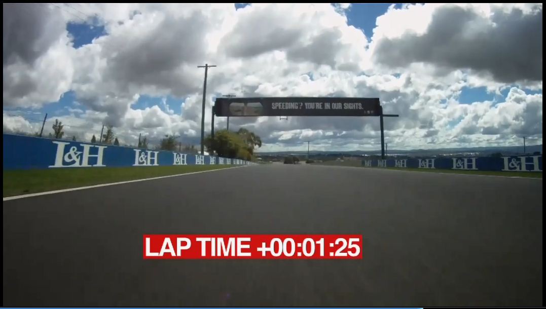

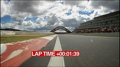

This was the mounting Position. You can see it on the front wing in front of the tyre.
http://img716.imageshack.us/img716/5384/65306947.jpg
Screen capture at 300kph
GoPro on F1 car at Bathurst - no WP case Awesome-300kph2.jpg   GoPro on F1 car at Bathurst - no WP case Awesome-300kph.jpg

The trick is to not use the Gopro mounts or case. It induces too much vibration. The case mounting prongs flex due to the mass of the camera and the case. Without the case, the 1080p mode (110 degree FOV) can be used at 25p vs using 720p mode ( 170 degrees) at 50fps. If the horizon is center frame, there is not much evidence of the fisheye/distorted look. However 50fps is smoother.
If you do use the housing, attach the camera with a 4 sided clamp arrangement, rather than the single bottom provided prongs. CMOS Jello comes from tilt rotation, if you eliminate or limit this jello is minimized.
To explain this better, if you raise the camera 2ft vertically but keep it on the same horizontal plane there is little change relative to the horizon. Think (crane or vertical slider). Even if you move the camera up and down 2ft 20times per second, there will be no jello. Tilt the camera on it's horizontal plane though and the horizon moves from the center to the top or bottom of the frame, this is what causes the extreme jello as the sensor scan reads top to bottom.
