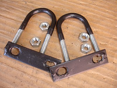

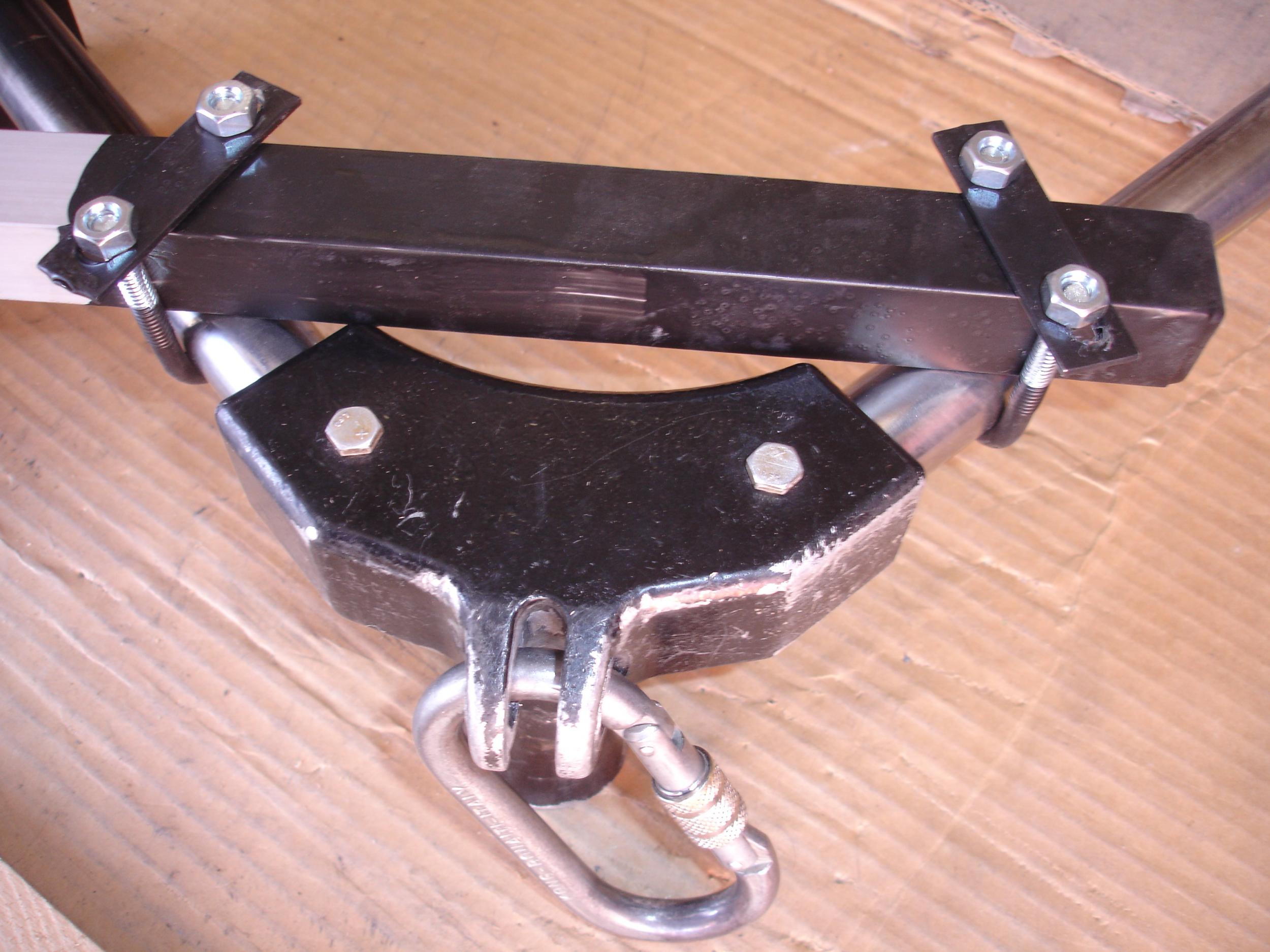

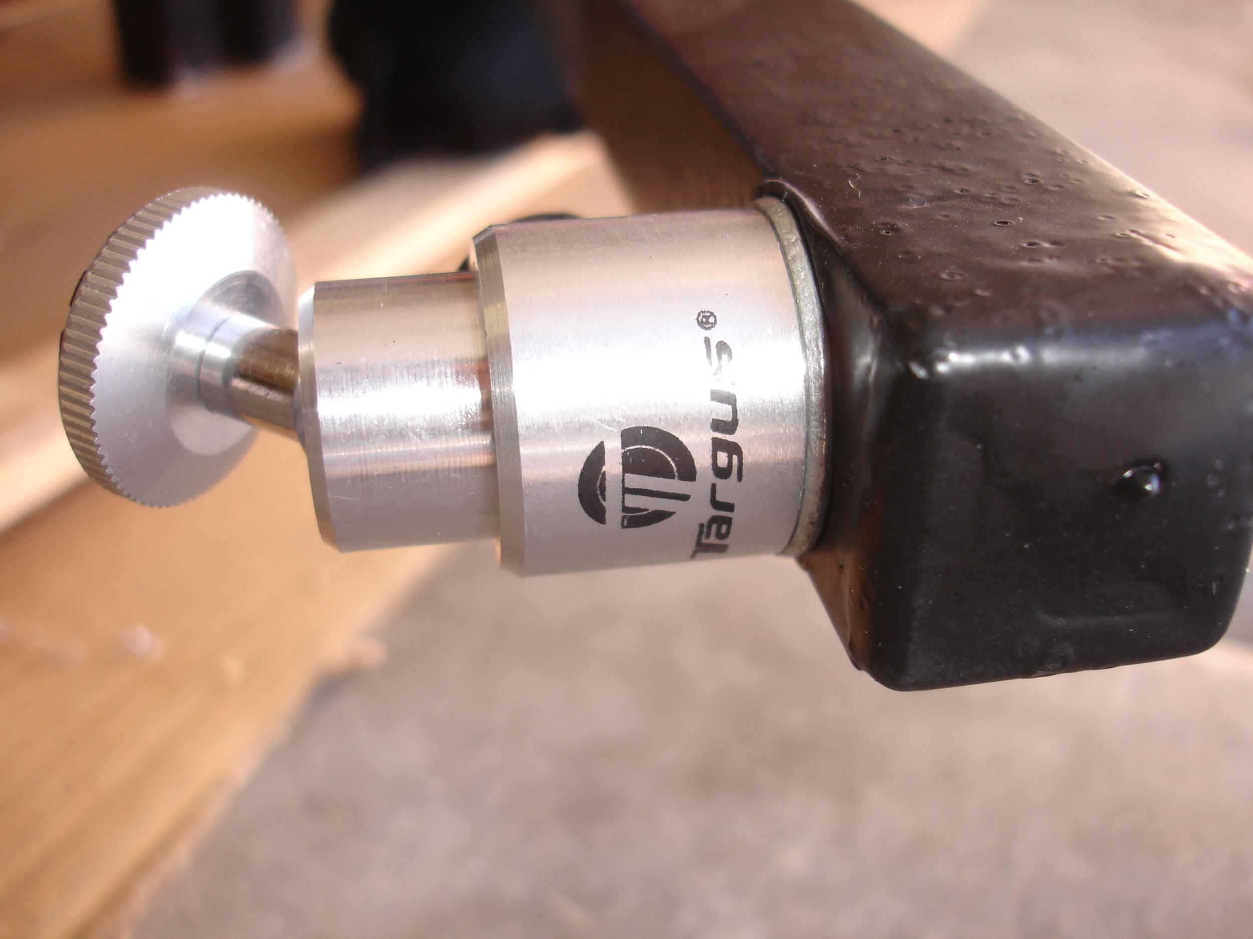

I made a mount a while back, at first I was going to go all padded and huge, ended up with a single 3 foot long 1" aluminum square tube that clamped on with U bolts. Capped the ends, added some rubber coating to the parts that would be touching the air frame and put a cheap mini ball head at the end.
I thought about tipping, as the best shot is always in harms way. The pilot said it usually tips to the wider side when it rarely does tip. So I installed the bar facing the skinny side. Needless to say it tipped and fell onto the bar! But I gave it enough extra slack to hit the bar and not the camera. The air frame is pretty flexible so it didn't hurt anything.
