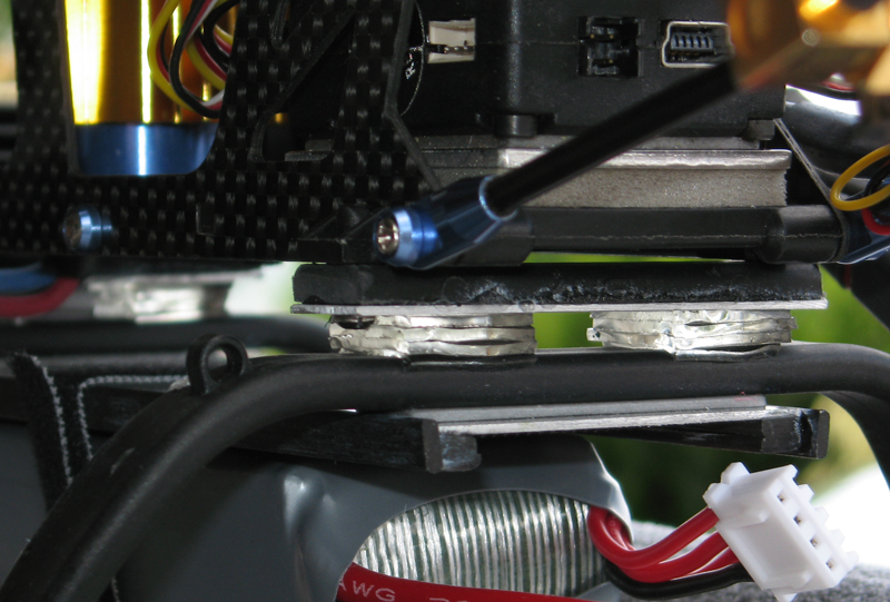

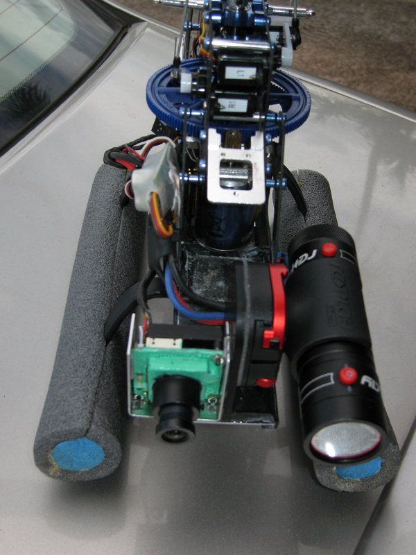

I got the Replay up in the air on my T-Rex 450. Here's a before-and-after comparison of the camera being "hard mounted", then with vibration isolation.
vib_test_20111011.mov - YouTube
At first the camera was simply mounted onto the helicopter using the "Heim Lock" mount that was attached to a standoff made of Plexiglass.
Afterward, I separated the helicopter into two assemblies: One with the motor and all the moving parts. The other with the main battery, both cameras and the landing skids. The two assemblies were joined with a vibration isolation "block" made of 3M's VHB adhesive.
It absorbs vibrations nicely and has significant holding power. A 9 mm square held at least 2 kilograms of sustained tensile load without peeling off. That's way more than the weight of the entire camera/skid/battery assembly at 10 g's.
As you can see in the video, there's a lot less vibration. But still more to go. I suspect that mounting the Heim Lock mount sideways has something to do with it. Plus the Plexiglass standoff.
So tonight I re-did the setup and hope to do a test flight tomorrow.

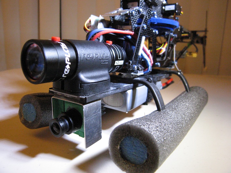

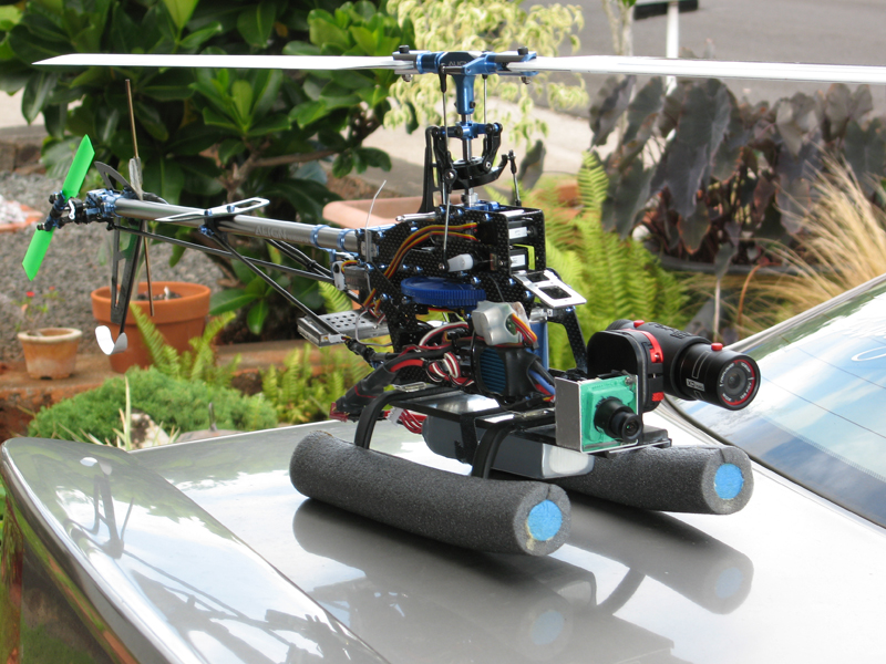

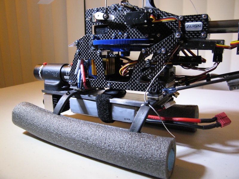

I modified the helicopter and centered the camera in an upright position on the lower frame. I'm hoping it's a more stable orientation for that mount. Here's part of today's test flight. The vibrations seemed to have been reduced. Not bad for a small helicopter.
I'm still trying to reduce some of the wagging of the tail. There are several parameters in the flybarless controller that deal with that, and it's not easy figuring out the values for each one. The user manual doesn't have any explanations, and everyone's been depending upon various experts online to help sort it out. Still, it does take time.
