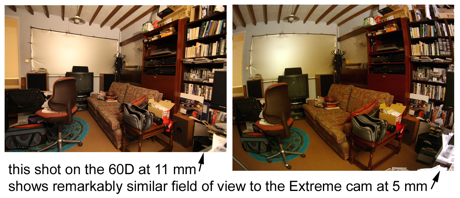

Just done a quick test between the Extreme cam and the Canon 60D with the Tokina 11 - 16 mm fitted. Shooting from the same position I notice both field of views are almost identical (apart from the barrel distortion, natch).
