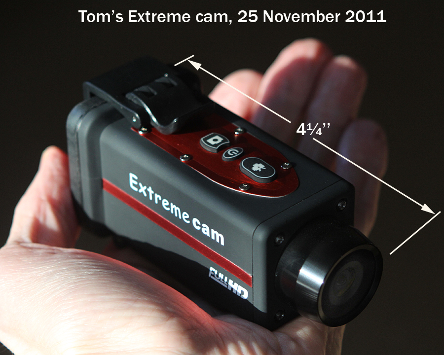

I've used the GoPro1 and written it up for a magazine. For its size it's bleedin amazing and from what I've read the GP2 is an improvement in many ways. I'm still not sure if the GP2 shoots sharp footage under water, but the flat front element of the ExtCam suggests it will. It flares into the light more than the GP1 but looks every bit as sharp.
Here's the Action-cam test on the thing that swayed me:
Crocolis HD Extreme Cam - A review - YouTube
It's considerably cheaper than Go Pro and comes with many bits that Go Pro charge extra for. So I have an array of brackets, clips, attachments, chargers (even a car charger) cables and adapters. Spare batteries are 4.99 at 7dayshop, delivered. 3.7v 1800mAh. Not bad. Only thing it needs is a lens cap, but the top off my little WD40 can fits perfectly.

Do I prefer it? Difficult one that. At a third of the price the EC is a bit of a bargain but it's let down in the audio dept and it's physically bigger than the GP. You say you would like to film a bit underwater so the GP1 is no good - it needs more money spending on a flat glass housing, For your hidden camera stuff the two cameras will be equal but even using the supplied tie-clip mic the EC's audio is hissy-horrible. Mounting it on a motorbike wont be a size problem, though on a headstrap you might prefer the GP size-wise.
And I hated using the GP without its rear screen - even with its huge wide-angle the guessing as to pov and tilt/yaw felt like working with viewfinder-less film cameras - having to wait ages to see the results. So that's another GP expense, you'll need the little LCD screen.
Another thought. The GP would sell second hand in a flash - the firm's reputation and exposure backs up their product. You might nave a spot more trouble trying to sell the EC - though a quick demonstration would convince the sceptics.
