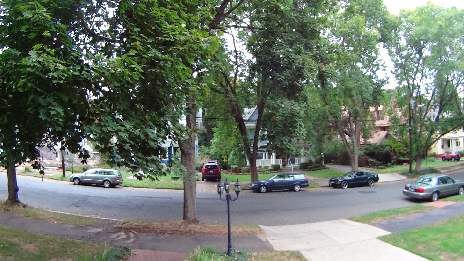

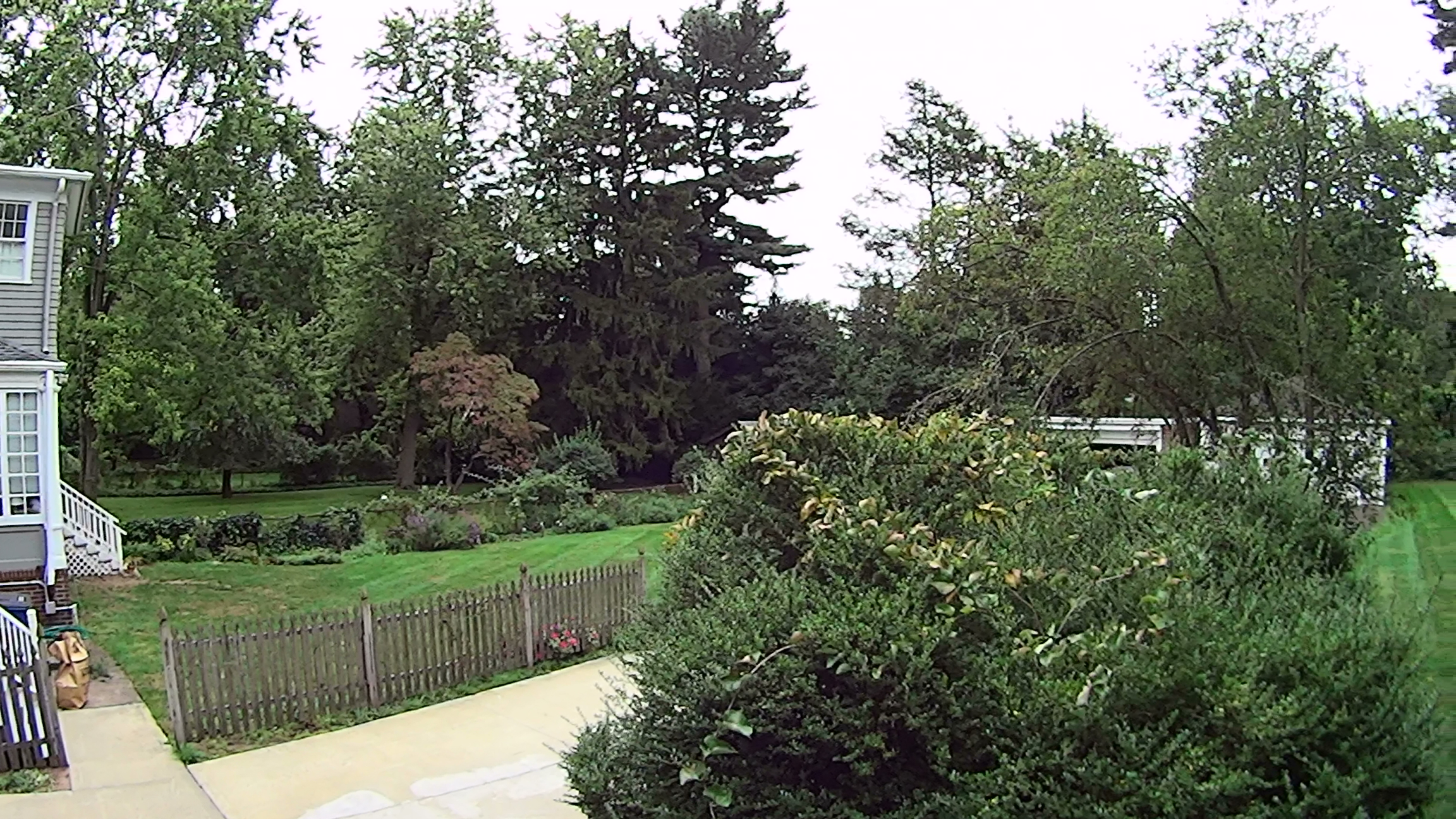

The Youtube videos are doubly compressed - by the maker of the videos in an editor and by Youtube. Here are originals from the camera:
1. An original jpeg taken from the interval recording mode.
2. A frame grab taken from the original 170-video on a relatively dark afternoon. This is the worst case, as the scene is highly detailed - even 108060p camcorders do not do that well, but they do better.
This is the best you get from cloudy end of day.
