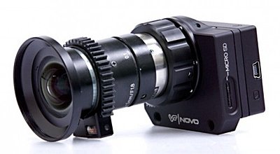

My biggest question is why can't there be a manual exposure/gain setting on this camera?? How can serious work be done with an auto iris/gain is jumping the levels all over the place. I want to use this camera on a UAV for a night shot descending towards the ground. There will be night lit houses, street lights etc. I want to see a dark, noiseless as possible city scape as our POV dives out of the clouds. I hope to shoot it at 4K 15fps and ramp the speed up to 24fps and beyond for effect (edit) IN post. What I read though is that there's an auto gain which will try to lighten up the image and cause unnecessary noise. I don't need a brightly lit shot just a relatively clean image for a 4K finish. It's a short horror film shot on Epic.
If anyone has a workaround please let me know. thanks

Rehoused HD3 Blk and modified Firmware
The groundbreaking Novo digital cinema camera, available exclusively at Radiant Images, is the perfect solution for cinematographers enamored by the capabilities of the GoPro Hero3 but frustrated by the Hero3’s cinematic limitations.
The Novo, developed and engineered by View Factor Studios in collaboration with Radiant Images, is a re-housed GoPro Hero3 that is even smaller in size and much more flexible and robust for cinematic purposes.
Key new enhancements include a C-mount lens system with back focus adjustment, which allows for extreme macro shooting, plus exposure control capabilities that open up a wide-range of artistic possibilities for cinematographers and camera operators. An internal CPU interfaced to the camera allows users to enable/disable the auto exposure as well as provide digital zoom for checking critical focus.
The lightweight aluminum housing itself is 20% thinner than the GoPro Hero3 and includes five 1/4-20 mounting points. Buttons on the front are assignable to several functions depending on the application.
And the Novo offers these added features while retaining the key functionality and accessories of the GoPro Hero3, such as the LCD touch screen, power backpack and WiFi connectivity for wireless camera control.
The Novo addresses the needs of cinematographers without compromising the power and versatility of the most advanced GoPro ever.

Contact radiant images, they have hacked the FW of the GoPro camera for exposure lock.

Thanks Ian, I've seen this rig before, the problem is it's only available as a rental, will likely cost more than the camera it's self just to rent, and I am very reluctant to put it on a UAV and risk it being damaged. The fact that the firmware can be hacked by a third party indicates that it should be very possible for Go Pro to implement it themselves. I would think that having iris control or at least iris lock would be a no brainer. Hope they are listening.
