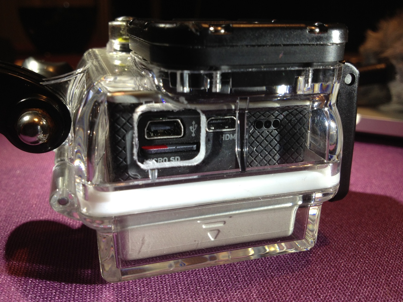

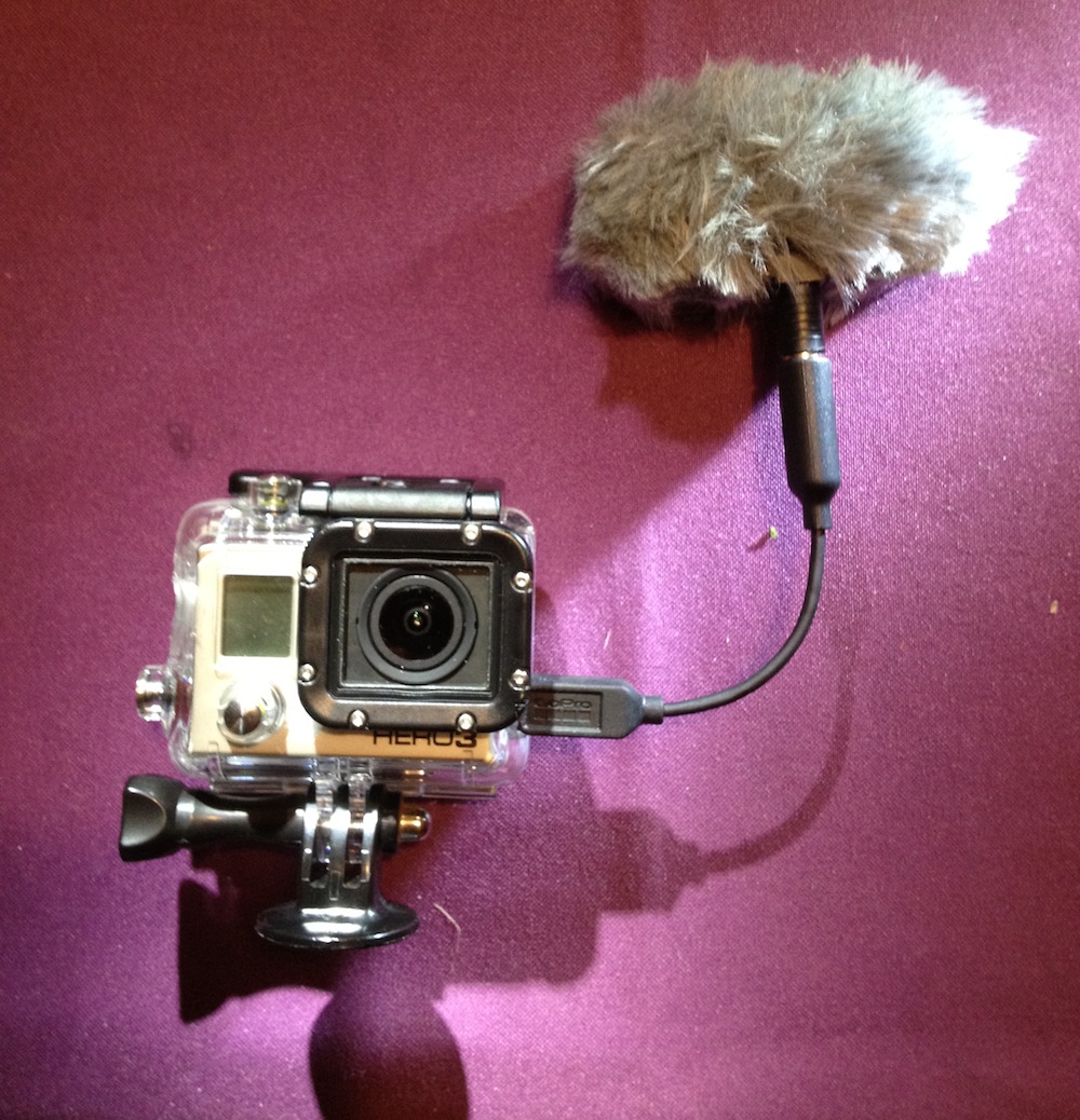

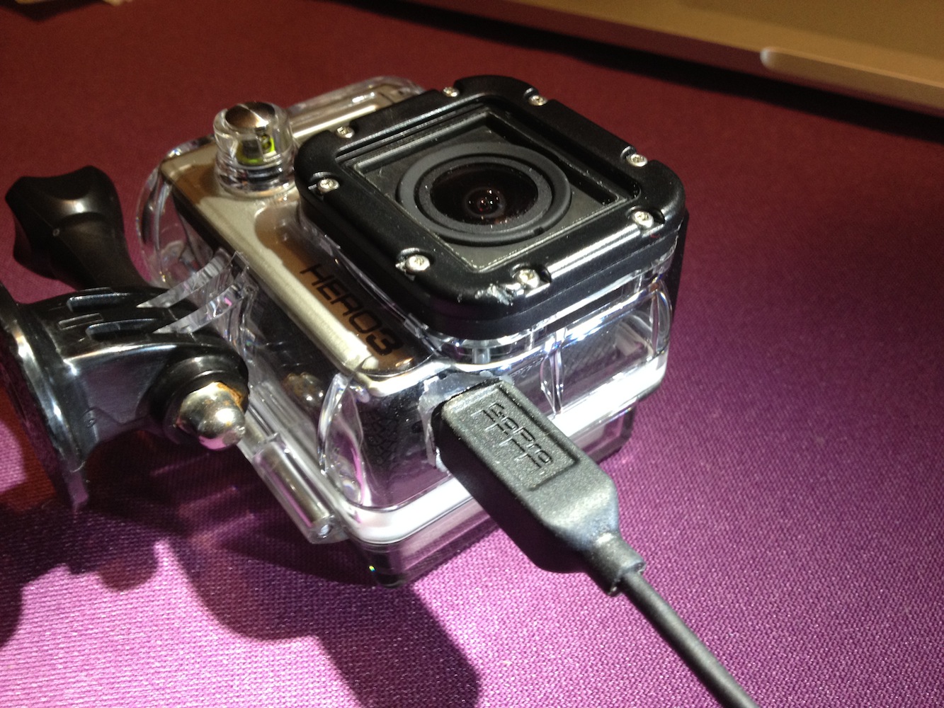

I wanted the GoPro to be able to get decent audio for the sake of sync and sometimes for actual field production under certain circumstances.
The Polar Pro mic, along with GoPro's mic adapter cable that plugs into the GoPro's mini-USB port, looked like it might provide a solution, but I didn't want the camera exposed to the usual salt spray and occasional splash. And, of course, it sometimes rains, too.
Using a Dremel tool and some sandpaper wrapped around a flat micro-file, I cut a rectangular hole right where the USB port would be. The hole is sized so it just barely lets the GoPro mic adapter cable plug solidly into the camera.
The audio is with this mic isn't as good as it is with the camera's built-in mic. It sounds a bit thinner. But it's way better than what I had before, which was a 3/8" hole drilled where the camera's built-in mic is, covered with a piece of microfiber lens cloth.
The microfiber cloth is actually good enough to prevent water from getting in. I had it on a fishing kayak all day long with it getting rained on and sprayed with salt water. The camera stayed dry.
I haven't taken this setup out yet. I'm planning to add some silicone to the plug so that it forms a skirted seal over the hole when the mic adapter is plugged in. Also have to make some sort of mount for the mic so it's not just hanging off the cable.

Simon... what's good about this mod is that you can use any mic that plugs into a 3-conductor 1/8" socket.
