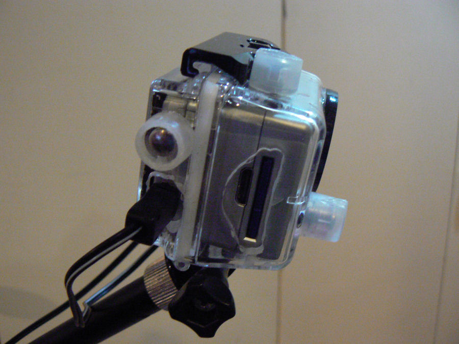

The only way to mount a GoPro is by having it in it's waterproof case, and as far as I can tell, that causes it to overheat, especially when running it on external power. I've been modifying the case, cutting holes to provide airflow and removing the glass from the case to improve the image quality - as well as providing access to the USB connectors and the SD card slot.
With all this, I rarely get through a whole concert without one or both of the GoPros crapping out.
Also, the mounting hardware is cheap junk. When you tighten the knobs, you run a risk of breaking them. But if you don't tighten them enough, they shake loose - especially the drum camera. The joints should be knurled with a radiating pattern of ribs to keep them from vibrating loose. And the parts should be made out of a less brittle plastic, more like the flexible but immensely tough plastic used to make the headbands of Sennheiser headphones.

I've modified my cases so they are basically skeleton cases now.

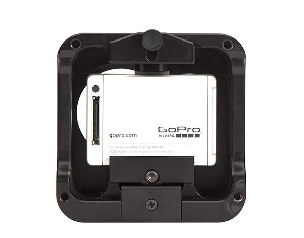

Take a look at our Cobalt Cage for the Hero 2. You can get the deluxe accessory kit which allows you to mount the camera naked in our open air cage, and pretty much guarantees you wont over heat.
You can also scrap the "cheap junk" hardware and use standard grip accessories like baby pins and maffer clamps to attach the cameras to anything.
For the smallest most compact setup, one of our Collins Clamp paired with a Billie Ball Mount would work great.

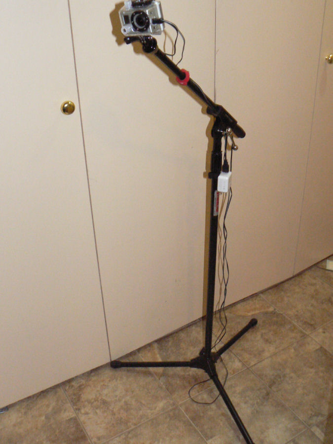

I've been playing around with different mounts. I tried bicycle handlebar clamps and clamping onto the snare drum mic stand, but that did not get high enough. I found a 5/8" microphone to 1/4" 20 tripod adapter. I put the GoPro tripod mount on that and screw the whole mess on top of my own microphone stand with boom arm. It's more to carry, but you gotta do what you gotta do.

I looked at the Colbalt cages and light stand clamps, and nothing, I mean nothing, that can't be clamped down tight is going to survive. I keep experimenting, but I tried three different photo clamps and gave up. What I'm trying now is using red Locktite on the tripod adapter to the 1/4" 20 thread, blue Locktite on the 5/8" to microphone stand and this special gripping goo that bike shops use to attach carbon fiber handle-bars to metal in the hated GoPro plastic parts. I lock that down with a screwdriver, and use the microphone stand's clamps - I know those can take the vibration as that is what they are designed for. I honestly don't think most light stands can survive a whole concert on a drum riser occupied by half a dozen different kids.
The Cobalt Cage is $100. The ball joint to use it is $55. I can do a lot of experimenting for that price, and I'm pretty sure that the further I get from the photo world and the closer I get to the Rock N' Roll world, the better.
