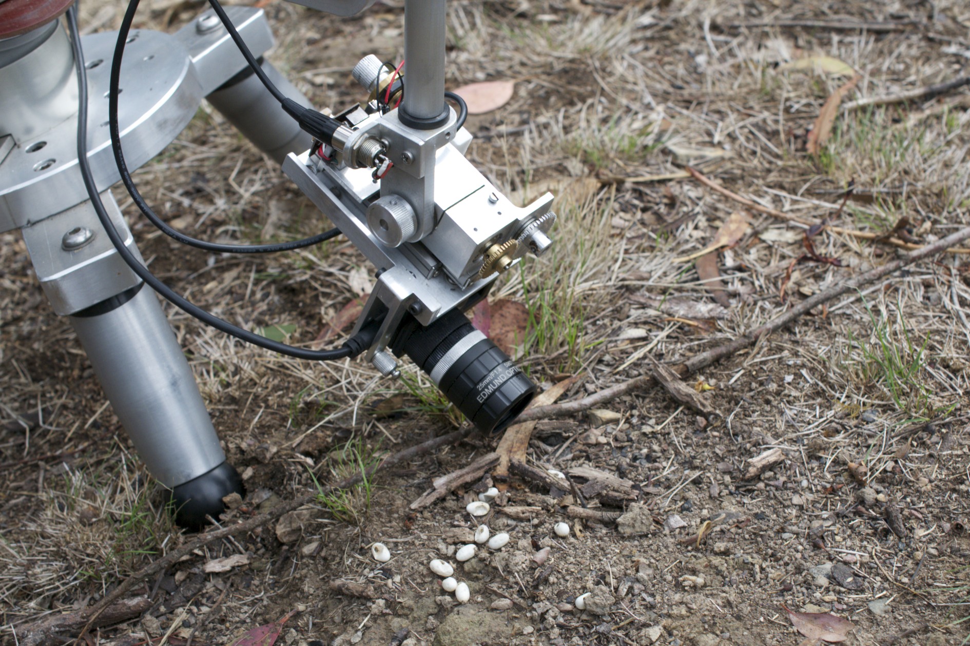

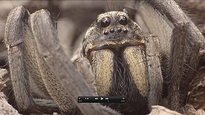

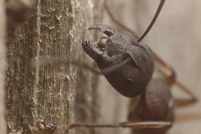

There are so many lenses to choose from one is spoilt for choice. I have been trialling a Back-bone modified GoPro specifically for close-up natural history work. As the camera is so small and light it makes positioning very much easier than for my EX3. I have tried several ‘C’ mount lenses either normally mounted or reverse mounted (for more extreme close-up). The lens shown on my test rig is a 25mm Edmunds Optics 59871 and the Lycosa portrait is taken with this lens. I have several other lenses to test including Switars and a Taylor-Hobson 25 mm Serital that appears to be sharper than the 5981. The ant head is done with the Serital (reverse mounted) on an extension - which I think was asking too much of this lens. The Serital is ~ 50 years old and would benefit from a clean. For wider angles and a greater depth of field I am trying a Cosmicar 8.5 mm f1.5 TV lens - usually with a 0.6 mm extension ring. Although I think my close-up results are useable I am not as happy with the results from more distant subjects.
As the list of options is so large I am hoping that some-one will me what I need, you seem to have the same problem.
