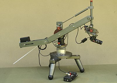

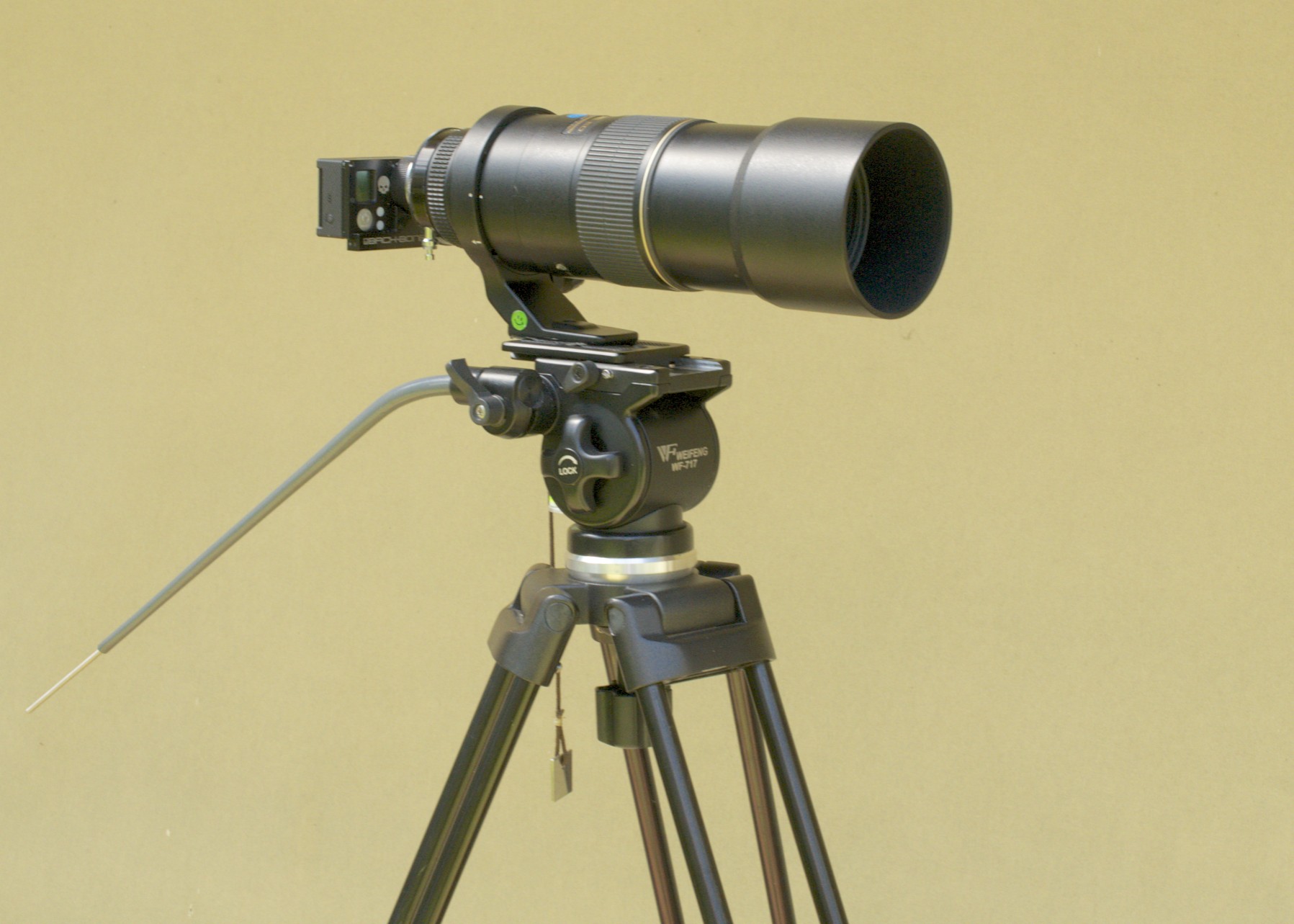

The versatility of the GoPro can be greatly increased by converting it to use other lenses such as ‘C’ mount and ‘CS’ mount. There is a large number of these lenses to choose from. In addition there are lens adapters available enabling the use of Nikon, Canon and other lenses. It is also possible to use the original lens.
Backbone.ca can provide converted cameras or will convert a your camera or alternatively sell a DIY kit.
I have Backbone converted versions of GoPros 3,4 and 5. My main interest is close-up natural history subjects where the small size is a great advantage. I connect the HDMI output to a recording type Video assist that gives me the option of having some distance between myself and the subject as well as the ability to see and record what is going on.
Below is a photo of a mini-boom set up. The boom is fluid damped and the camera is mounted on a motorized slide that I use for focus. It is built on a 3” ball and is shown here mounted on a fairly solid low level tripod used both in the field or on a bench.
The other photo shows a GoPro 4 attached to 300mm Nikkor.
The ‘C’ mount is not ideal but it does increase versatility.

Alistair's add-ons completely defeat the purpose of having the GoPro's diminutive size be less intimidating. Also, I fail to see how a "naked" GoPro would be given how wide of an angle the built-in lens is. You'd have to mount it really close.
