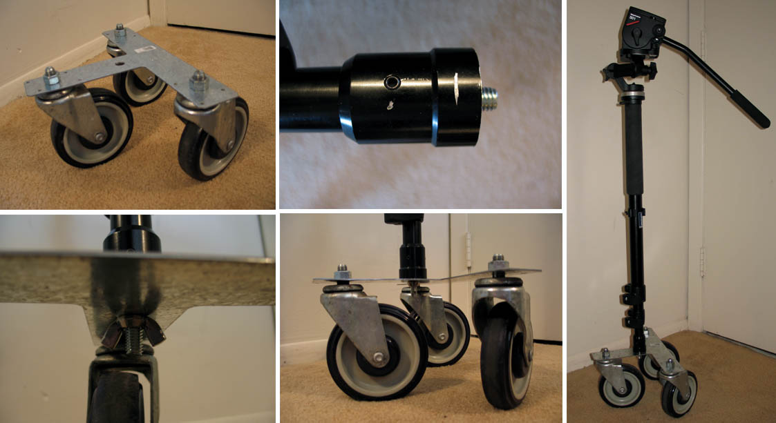

The prototype is up and running. The test will be next weekend, since I don't have a dance floor or a church aisle in my apartment. What I notice right now with this design is that there is some drag on the carpet while the wheels have no drag on the kitchen floor. It weighs 5.5 pounds.
Right now I am wondering if a 4th wheel would be better for balance.
All comments and ideas are welcomed.

Looks good. You'll always get some drag on most carpets. You might also consider making a second base with the wheels about twice the distance apart you've got this set. Might give you a bit more stability.
Harold

A wider base may be the key to better balance. A 4th wheel and moving the pole to the center might help too.
It's not a lot of work and it is fun, so don't ask why. It's like asking why do the birds sing?
There are a few shots where this invention will work well, and maybe even a few surprise shots, too.
My 1st shot, that the boss likes, is the walk down the aisle with the cam pointed at the guests in the pews.
The 2nd is the 1st dance and parent dances.
But who knows there may be times where I am wheeling around in front of the alter following the Bride and Groom as they light the unity candle.

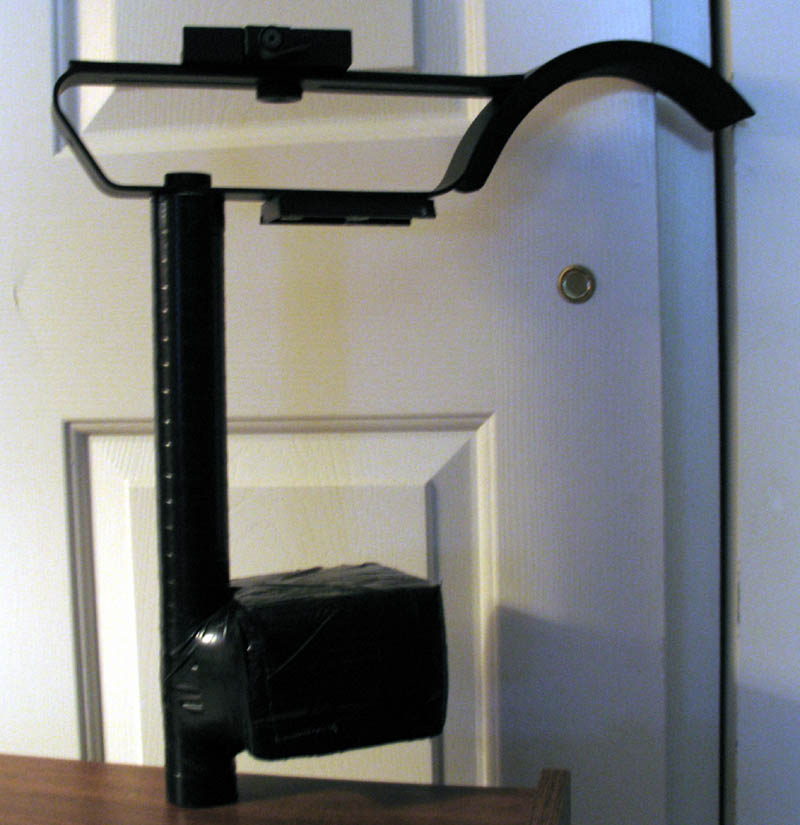

This invention might not be for every wedding and hall, but there will be a few where it will work well. It is a tool like my modified shoulder support (which I absolutely love) to offer me options.
Also, I can connect to the monopod, tripod, & shoulder support in less than 30 seconds. Try that with glidecam.
Why would I adjust the height. I have 501 head on it with a 3d head below that.
After the wedding next weekend I will post footage and my conclusion.

Well I couldn't make it work to my liking. It was either too easy or too hard to move. Also, the balance was bad.
I tried it at the church and had a hard time wrestling it to stay balanced. At the reception it was better, but still the same problems. On the dance floor it felt like it was rolling away from me. On the carpet it was hard to push and keep balanced.
However, I have not given up on this idea.
