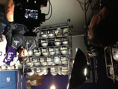

For audio on my D800 and D7100, a simple external microphone such as the Nikon ME-1 or Audio Technica Pro-24CM work great for run and gun, auto level. For more formal interviews, I plug a Sony UWP-V1 directly into the microphone jack, manual level. Audio is clear and free of hum or noise. The Nikon Preamp seems fine and I actually have only been using the camera to record audio.
Also recently I bought Beachtek MCC-2 and had some success with two wireless microphones running on auto level at the same time. Of course I would suggest caution and testing before going into the field. Most of the time when interviewing its in a controlled environment.
With the microphone input jack I have had some problems with cheaper 1/8 stereo cables not giving a good connection. A good quality microphone and cable go along way. Sony's included cables work great, Beachtek cables also worked.

Below is a picture of my Nikon setup during an interview.
