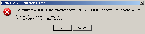

My PC started acting up lately when clicking on a DV AVI file, sometimes even without clicking on a file, just placing the cursor over it (I guess that would still be clicking as I have Windows set to select the file by placing the cursor over it and open it when clicking once).
See attached image. The numbers in the first "0x0..." are changing every time this happens. The message just sits there on the screen until I click OK, that will close the folder, screen goes blank (background only, desktop icons will dissapear, then come back). This happens with both folders on the local hard drive and external/USB drives.
Any idea what might cause this? I can still access those video files opening them directly with any application that would play them or process them, so the files themselves appear to be just fine.

What application is set to open .avi files by default? Could that application be the problem? Try opening the files with the application assigned by default to see if you can replicate the problem. That application may need to be re-installed.

If it is crashing without even clicking then it is quite likely you have a codec that isn't behaving properly with Explorer.
Explorer interrogates the file to get information and also generate the thumbnail.
Have you installed any third-party DV codecs?

If it is crashing without even clicking then it is quite likely you have a codec that isn't behaving properly with Explorer. Explorer interrogates the file to get information and also generate the thumbnail. Have you installed any third-party DV codecs?
The only other DV codec isntalled is the Canopus DV codec that came with Procoder 2. The error issues only started about one month after installing Procoder.
Other codecs installed (not DV codecs though) are Divx and Huff YUV, not counting the codecs that came with Windows of course (Cinepac and Indeo).

Thanks for all the help guys, especially you, Jeff. I went through most of the links - it looks like pretty much anything can cause this problem...
I did some more testing in the meantime. The same file (on a USB hard drive) works fine on a second computer, but it exhibits the problem on a third one. At the same time, other DV-AVI files may or may not work properly on my work computer, the one that started acting up.
At this point in my investigation I tend to believe that I caused the problem by pulling the USB cord without executing "safely remove hardware". From what I'm reading Windows does some sort of "inventory" of the files on all attached hard drives (called indexing?), and when a drive is disconnected in the middle of this process, a hidden file containing this data gets corrupted. If I drag and drop the file rapidly into any application that can load files this way, all is well. But if I leave the mouse resting on top of the file until it displays it's characteristics, that's when I get the error.

As mentioned in the original post, I had this computer set to open files with a single click (after pointing to select the file) – so I tried changing that back to the default where placing the pointer over a file will just display file properties, first click selects, and second click opens them. My habit of changing the default double-click to single-click got me into trouble already a few times… on top of this I also had the mouse pointer set to “snap”, in other words to automatically move the pointer to the default button in dialog boxes. It happened a few times that I was trying to click on something, but just then a dialog box opened (from a program running in the background) where I really wanted to select not the default button, so when I clicked, what happened is not what I wanted to happen.
Long story short, this is what I discovered. When I place the mouse pointer over a file icon, a little yellow box opens next to the icon (or thumbnail, list item, whatever the view is set to), displaying the file type, title, size, date modified, dimensions, etc, depending on the file. And THIS IS WHEN THE ERROR MESSAGE POPS UP! It takes about two seconds for the computer to read this info – if I move the mouse away in less then two seconds, nothing bad happens, I can even click and open the file as long as I move the mouse away immediately after. If I leave it resting on the icon, boom, error.
I think this is pointing me (pun intended) toward thinking that the problem is the file containing this information.
