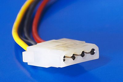

You're issue is the amount of cables. There are always adapters included in the box of these video cards to convert 2 standard HDD power cables into 1 6-pin PCI-E and if you buy 2 cards, you get 2 of them for use on one card.

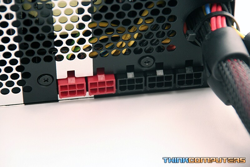

I also understand that your power supply is modular, meaning you can use less cables. with the use of 4 standard HDD ports, you should be fine since your HDD and disc drive should be powered by SATA anyways.

I have two of these ports (pictured left) just sitting in the case doing nothing, so if I can convert them into a single PCI-E power cable, and I use the two that are already in there, I'm still one cable short!
Second picture is the back of my power supply and neither of the two red ports on the left are being used at the moment - they are just empty. Are they options? I don't know what they are.
This is from a review of the PSU which makes no sense to me but may add to those trying to understand it:
The sleeved cables will help with airflow, and the modularity of the power supply will help with cable management. The modularity is arranged with four regular spots and two spots meant for 6-pin PCI-Express cables. These last two spots can be replaced with regular cables if needed. Some of the cables are not modular-they are wired into the unit in the regular fashion. The connectors include one 20+4 pin motherboard connector, one 12V EPS connector, one 12V ATX connector, two 6+2 pin PCI-Express connectors, two 6 pin PCI-Express connectors, eight SATA connectors, nine 4 pin device connectors, and two floppy connectors.
