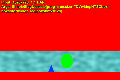

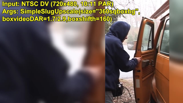

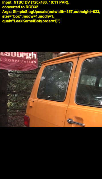

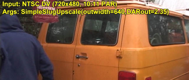

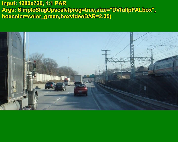

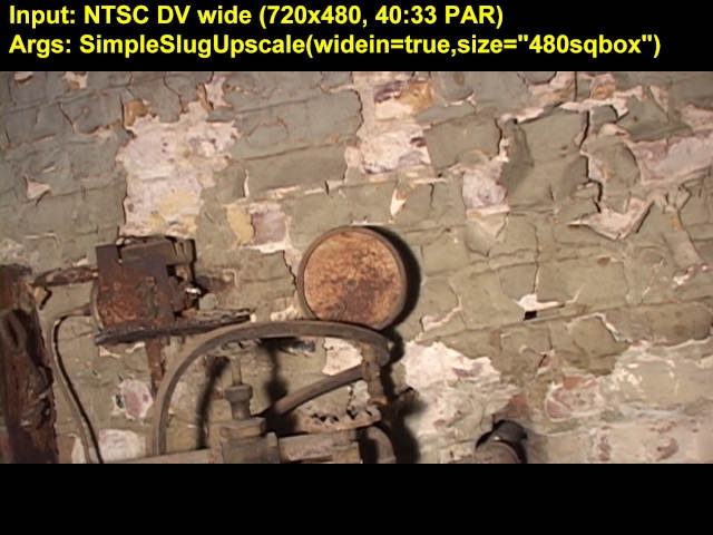

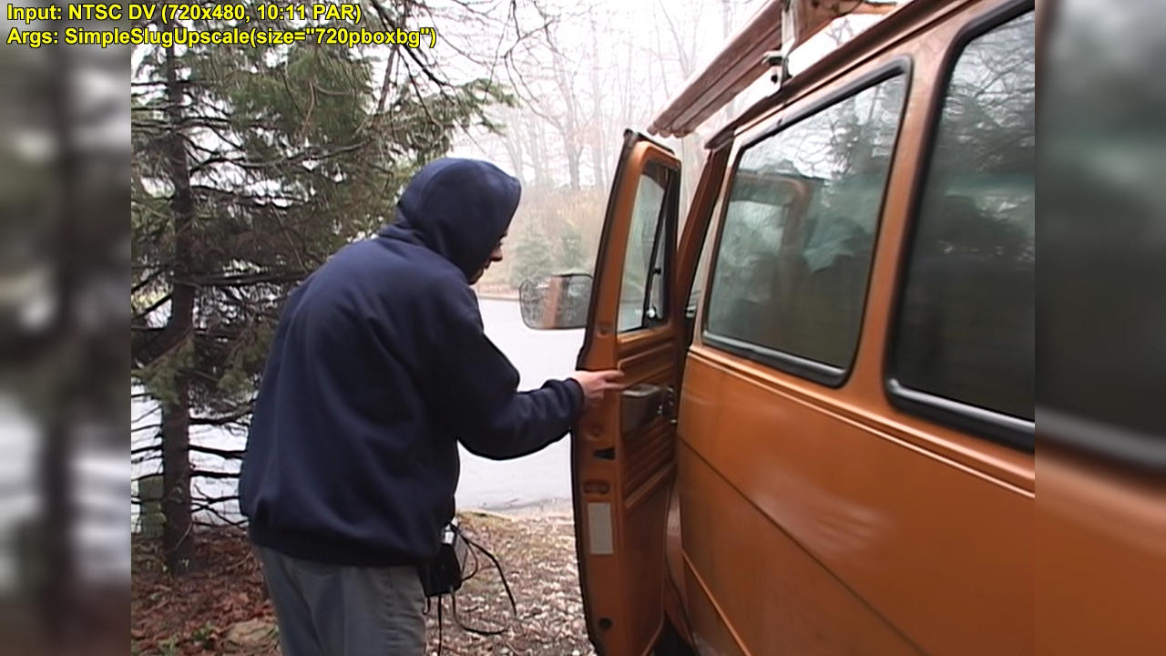

On another note, I didn't want to bother people with more updates to this thread, but since I'm responding I'll note that SimpleSlugUpscale has been significantly improved over the past four months, and can now turn any size and shape input into any size and shape output. It's still "simple", if you're just interested in the basic functionality, and it's still a "slug", if you use my default deinterlacing plugin, but strictly speaking it's no longer just for upscaling. Nor does it require you to know all the details of the output you desire.
The basics are introduced in the documentation (included in the script itself), but to demonstrate, I've uploaded a few sample images. For starters, let's say you wanted output that was 640 pixels wide, and had a display aspect ratio of 2.35, but you're not sure what vertical dimension is required for that. You'd just use
SimpleSlugUpscale(outwidth=640,DARout=2.35)
and your output would be the final attachment, "outwidth640DARout235.jpg". The overlaid text is just for the purpose of demonstration, and isn't applied by my script.
Update: I only just noticed a tiny mistake in my script that renders the following italicized passage incorrect! 272 is a multiple of 16, and will now be the resultant dimension for the arguments given; at a couple of points in the script I used a Ceil(), which always rounds up, instead of a Round(). It helped certain cases, but it's not ideal for most, so it's gone. The script has silently been replaced with a corrected version, but I thought I should leave this here for reference. You'll note the vertical is 288, instead of the expected 272, and that's because by default, all output dimensions are mod 16, for most efficient compression (most video codecs, as I understand it, still use 16 pixel macroblocks). I thought that would be more important to people than perfect aspect ratio, but if you want more accuracy, you can change the 'modw' and 'modh' parameters as you see fit. Keep in mind that the minimums for progressive YV12 color are 4 and 2, respectively. If you want single pixel accuracy, you'll need to set both modw and modh to 1, then feed SimpleSlug RGB input.
The rest of the attachments demonstrate the various effects one can achieve by way of my automatic letter/pillarboxing, and are subtitled with both a description of the input and the arguments passed into the function to get each result.
How to upscale from SD to HD?-720pboxbg.jpg   How to upscale from SD to HD?-480sqbox.jpg
How to upscale from SD to HD?-dvfullppalbox.jpg   How to upscale from SD to HD?-dvwidepntscbox.jpg
How to upscale from SD to HD?-360sqboxbg.jpg   How to upscale from SD to HD?-357x623box.jpg
