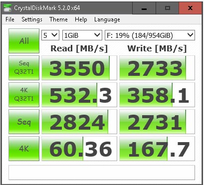

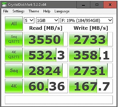

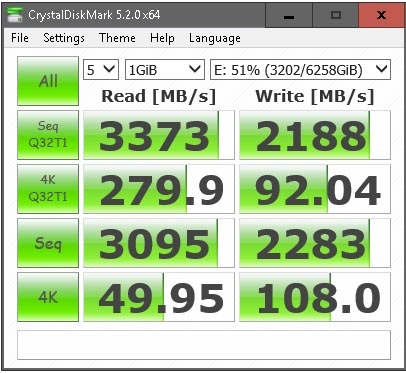

Wayne, modern M2 or U2 NVME drives are faster than even an 8 SSD RAID 3 using a dedicated Areca RAID card - as well as being cheaper. See the two attached Crystal Disk drive speed charts.
I have just replaced my Areca RAID with a 2TB Samsung M2 NVME, and a 3.2 TB Intel U2 NVNE, and my editing with 4K material is much improved.
I accept that file security is reduced, but I have multiple off-system backups of my source files, plus an external backup of my two media drives, just in case!
New Computer system for Editing-8-drive-raid.jpg   New Computer system for Editing-970-pro-m2.jpg
