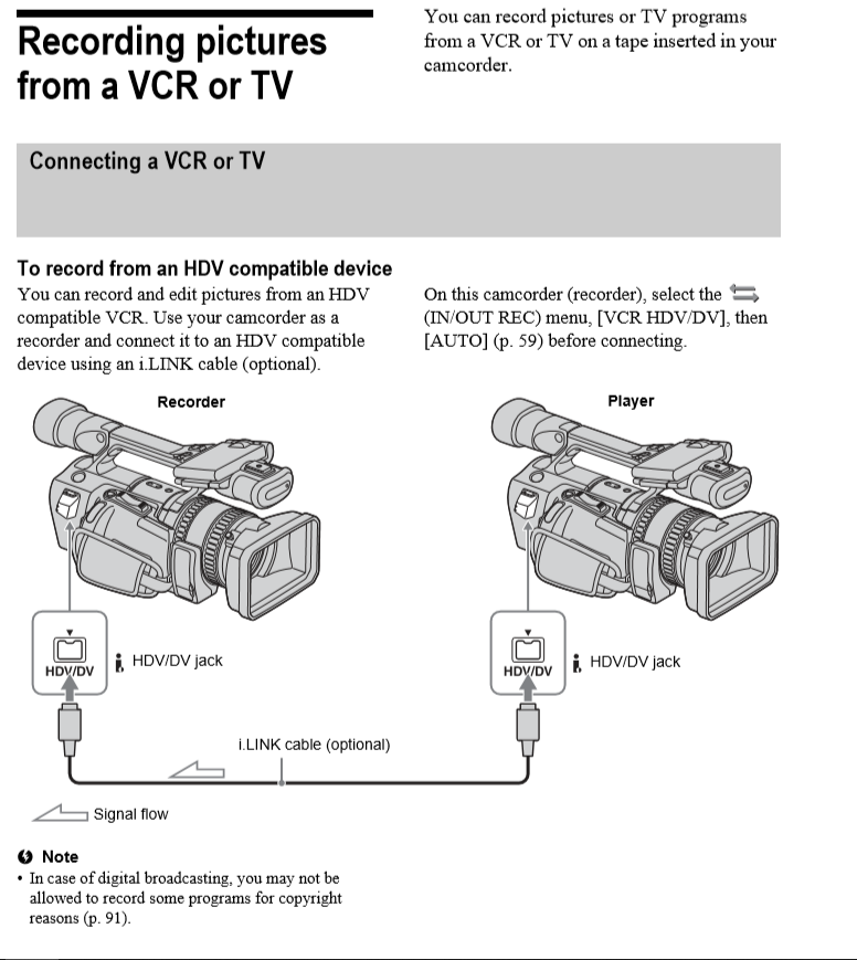

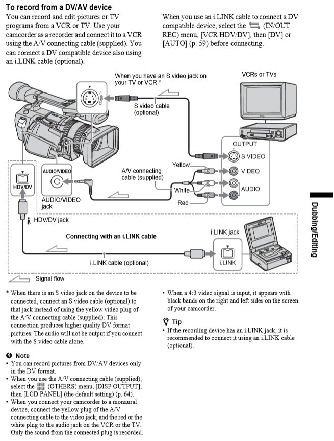

I'd try a different VHS playback deck. Also wouldn't hurt to double check your menu settings on the camera. Both the NTSC and PAL versions of the camera are capable of recording off a VHS deck, according to the manuals. Since you've already eliminated the cables, I suspect a faulty VHS deck.
Mark
Capturing VHS to minidv tape-fx1-manual-page-74.png   Capturing VHS to minidv tape-fx1-manual-page-75.png
