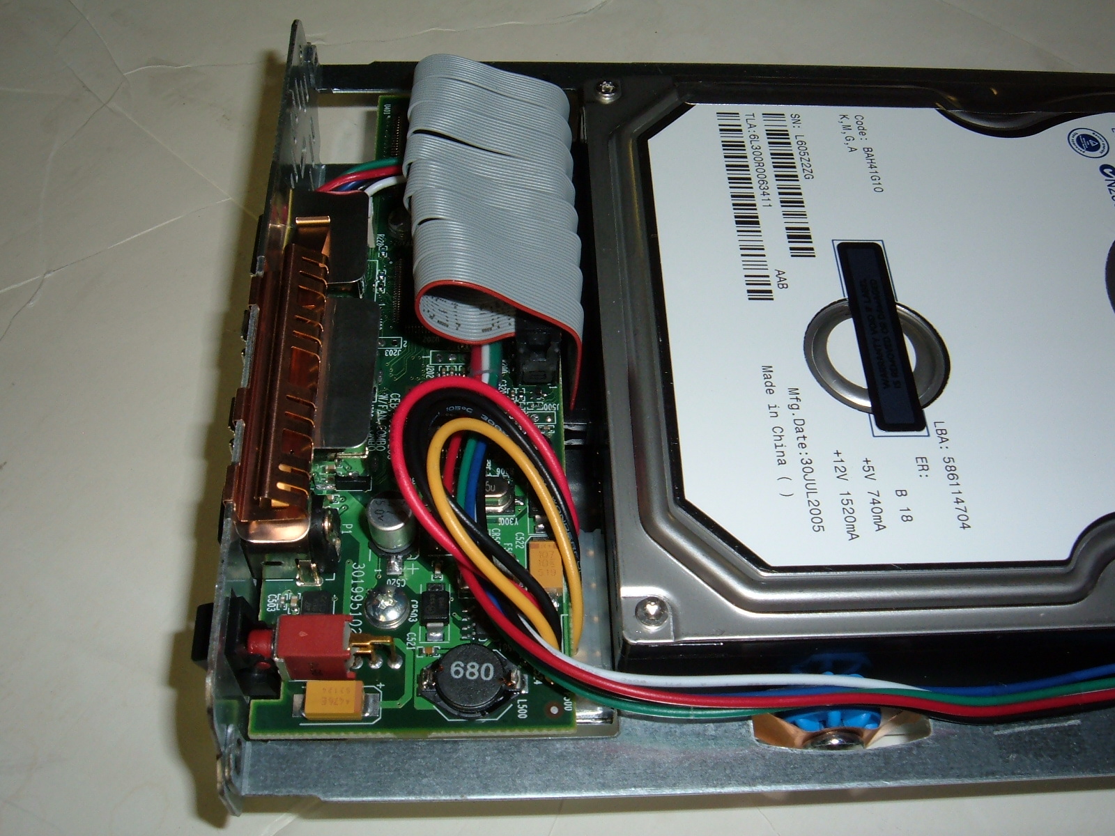

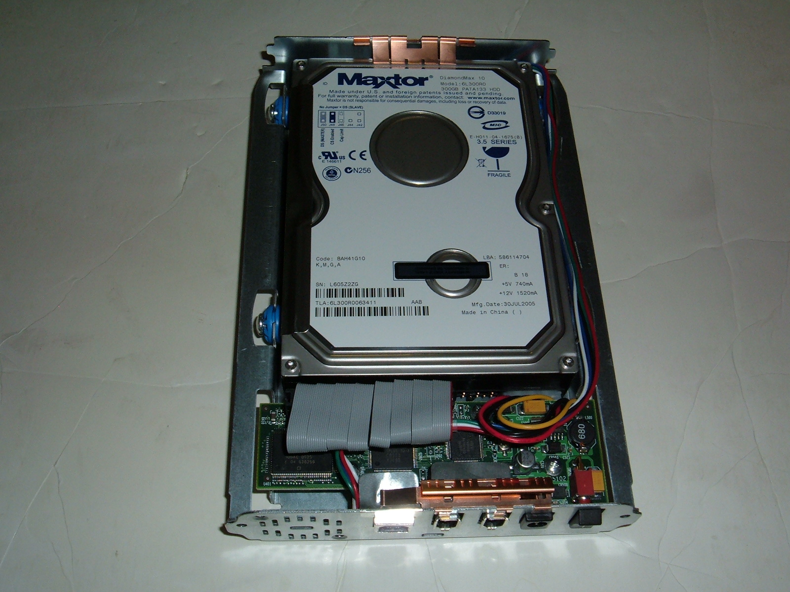

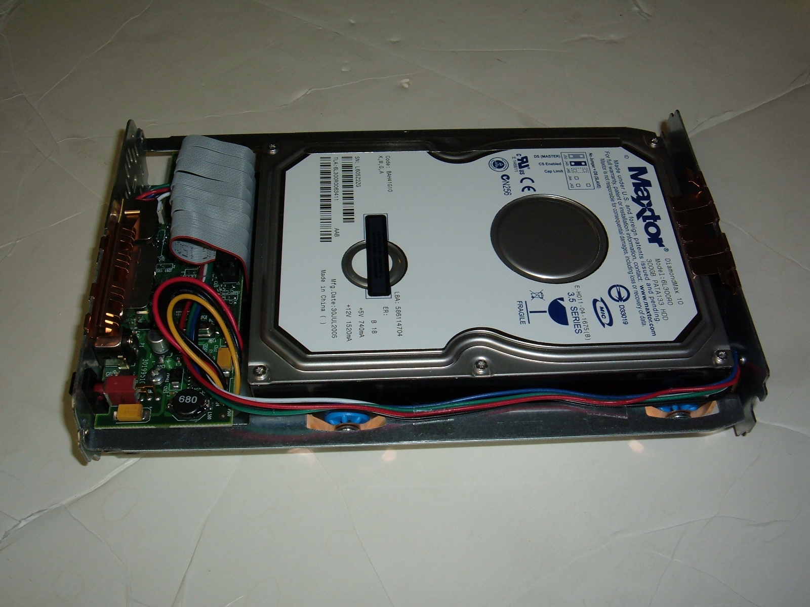

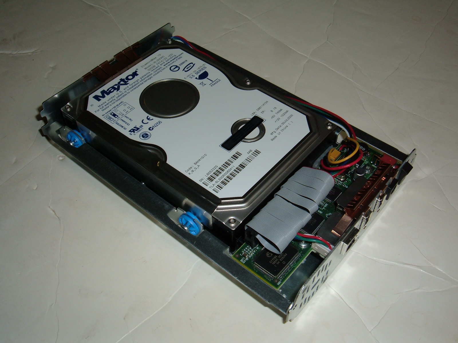

Here are some images of the drive when it was removed from the case for anyone who hasn't seen how it works. If the interface board was found to be the problem and the drive is fine, it seems to me that Maxtor would offer a replacement of only the interface board because all of this is simply removing a few screws and unplugging a couple of cables. Alot of time and money could be saved for the end user if it was done this way.
Drive Image 1
Drive Image 2
Drive Image 3
Drive Image 4
Drive Image 5
Pretty much just like I described to you earlier in this thread, huh. In pictures 4 and 5, you can see the master/slave/cs jumper between the data cable and the power plug. Very likely that the drive is okay.
