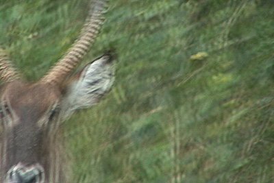

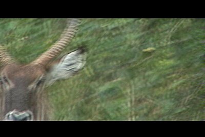

I have a Sony video monitor that is 4:3 (not just a TV set). The very problem you have described - namely wanting to view 16:9 material correctly on a 4:3 display - is what has driven me to develop a realtime software aspect ratio converter (see http://www.dvinfo.net/conf/showthread.php?t=69068 ) and I'm actively seeking beta testers. It will let you play an AVI file (e.g., created by Premiere) out to a DV device, converting the DV signal on the fly so that it will appear correct on a 4:3 display.
Attached are a before and after - the example is deliberately chosen to show how interlacing is correctly handled.
I hope to make the beta available for download during the coming week.
