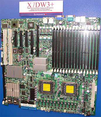

Agreed, unless you have a mobo like this:
Old May 16th, 2007, 02:12 PM   #26
Location: Orlando, FL
Posts: 404
Who else is hungry? :)
Eric Shepherd is offline   Reply With Quote
