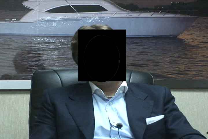

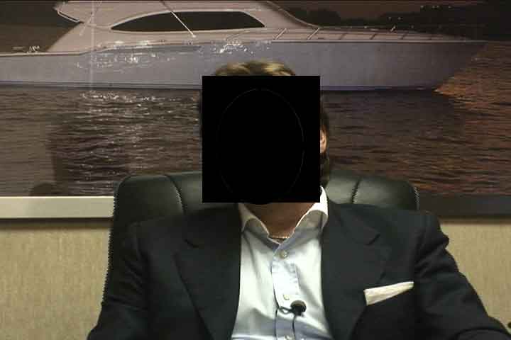

I have some interview footage shot under a fluorescent light. The shutter speed was to high and has a color shift or "phasing" issue. I saw the thread on why this happens (http://dvinfo.net/conf/showthread.php?t=98260). I'll add a little extra here to help with keywords for people with the same problem. It is as if the white balance were alternating from warm to cool and back again. The image is very warm (deep yellowish brown) and over the next 3 seconds it becomes cool (bluish hue). In It is a contant 6 second cycle.
Here is my question: Any ideas on how I can fix this problem in post? I am editing the footage in Premier CS3 and do not have the ability to make it black and white. I only need a usable 15 second clip to identify the speaker and can fill the rest with b-roll.
Screenshots are attached.
Thanks for any help you guys can offer!! Hopefully someone has an idea FAST!!!
Eric
Fluorescent Lighting color shift due to high shutter speed-cool.jpg   Fluorescent Lighting color shift due to high shutter speed-warm.jpg

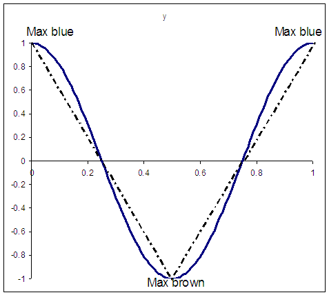

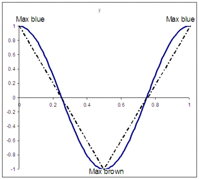

Following on Giuseppe's line, the color shifting will be periodic. Review the footage on the timeline to try to work out the period - i.e., how long it takes for the color shifting to complete one cycle. Now the somewhat tedious/tricky bit:
Apply the color correction effect at one extreme of the shift - e.g, when it is most blue. Go to the opposite extreme - e.g., when it is most brown/yellow - a place a key frame there. Go to the next extreme blue and place another key frame. At this stage, you have three key frames and the color correction effect will simply go from one extreme to the other (literally) in a linear fashion (a triangle wave). The problem is that the actual color shifting is most likely sinusoidal. See attached image of the triangular and sinusoidal shapes (strictly cosinusoidal but it doesn't matter).
So, a simple linear change in the color correction may underestimate the correction required. I would try it first. If it does, then I'd start adding extra key frames to define the sinusoidal shape more accurately.
Once you've got one cycle done to your satisfaction, you should be able to copy the correction effect to the rest of the timeline.
Good luck! I don't envy you this one. Maybe someone else will have a simpler solution.
John.
