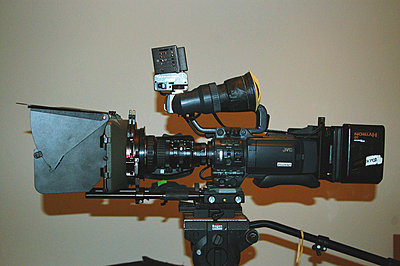

Photo of entire camera added per request. Shown with french flag and side flags.
