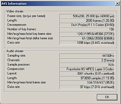

It's right there, see attached - unless you're using some old version.

I'm using vdubmod 1.5.1. I get the same no decompressor issue using hdv and mpeg. When the mpeg video finishes parsing out then the footage loads. I go to file and then fine info. It give me most of the info as in your image below but the decompressor info is missing. It is present when I load an avi file though. Maybe I'm asking the wrong question. So let me ask which codedc for vista and xp allows vdubmod to open HDV and mpegt files?
