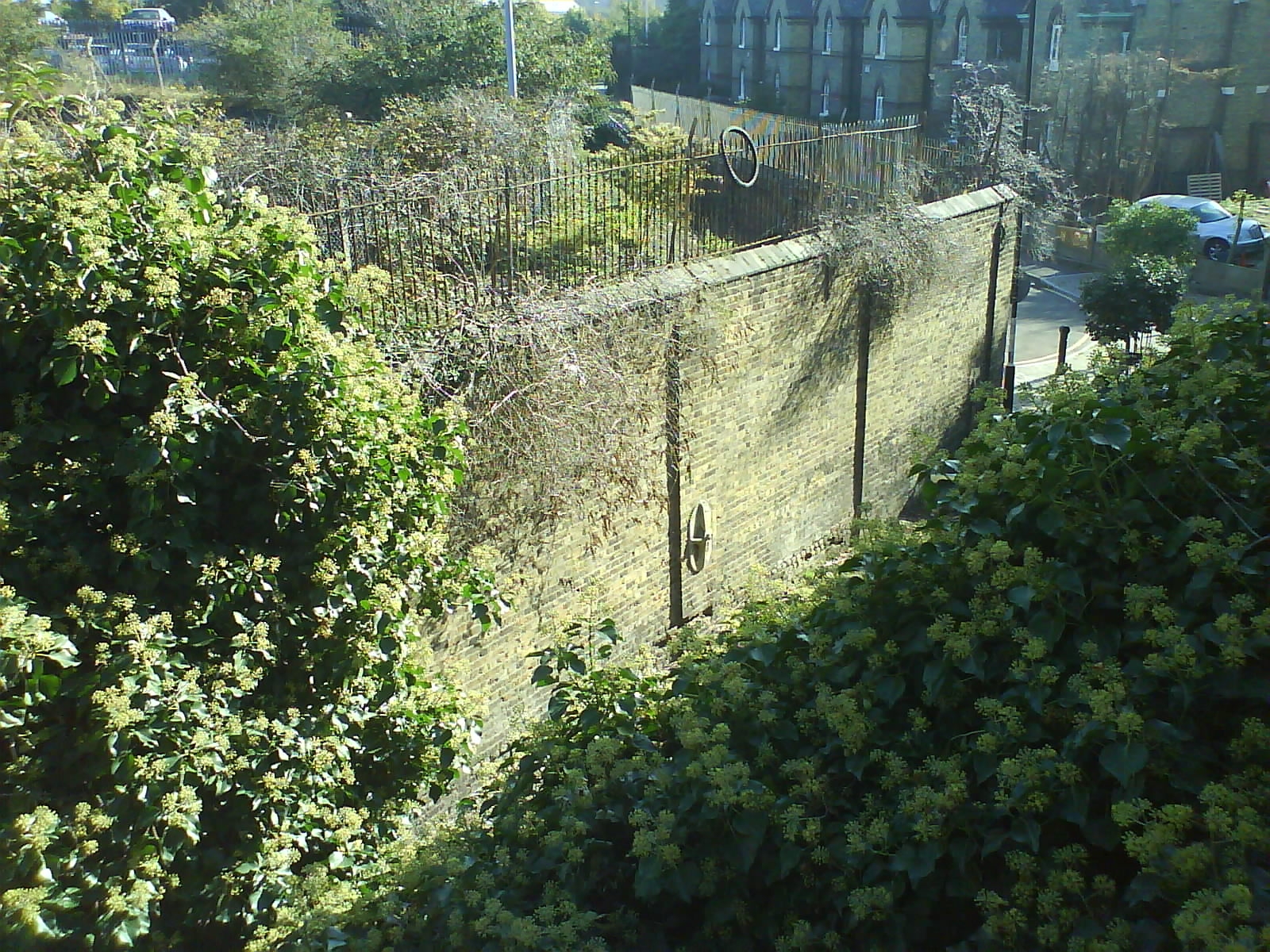

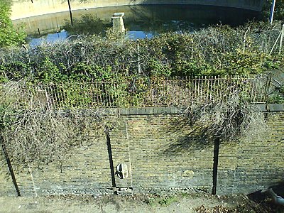

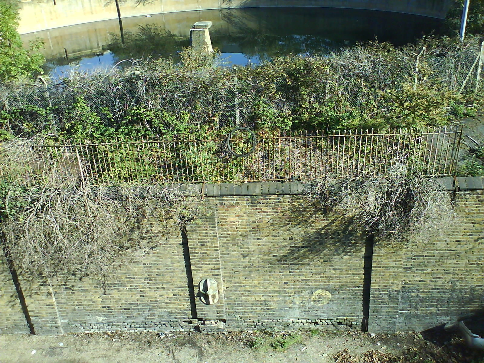

Hello, I hope this doesn’t constitute a thread hi-jack attempt, but I didn't want to start a new thread and my question is regarding ziplines.
I’ve joined this forum because for my first module on my Dance: Urban Practice BA is called Dance for Camera. We are required to prepare a 3 -5 min piece of dance film so I’ve been busy checking out knowledge banks like forums (more up to date info, etc) and websites. We also have to submit a treatment and pitch, along with storyboard and so before I can do this I need to sort out a problem with an almost inaccessible area I want to film. To make matters worse, we have been banned from using the zoom feature (our lecturer says it gives an amateurish student-quality to the films) on the DV so my problem is this;
There is a bridge overlooking a wall which runs parallel to it which is about 30 degrees and 60 feet below (I have a picture but I am a newbie so can't upload attachments). I will be situated on the wall with the camera. I wish to have the piece start with a cluster of tangled hands scrabbling and fighting for purchase on the wall. I want to pull away gradually so that at the end of the tracking/zoom, the camera POV is from the bridge. Does that make sense? Naturally my first idea was to shoot from the bridge with a slow zoom in to the hands (about 12 pairs of hands) and reverse in Final Cut, but having the zoom feature banned kind of scuppered that.
I was going to rig up a simple zip line and have the camera either track back in realtime, pulling it back up the cord, or tracking forward (and therefore reverse in final cut).
Is this over-complicating things? Is there a more simple way to do it? I want the zoom out effect to be slow.

I contacted Chris offline to send me the photos he can post so here they are:
Zipline for cameras ever used one?-wall.jpg   Zipline for cameras ever used one?-wall-2.jpg

Both pics are taken from the bridge, the face-on shot is more representative of the angle I want to film at.
Thanks again
