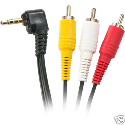

Here you go (and in the UK, too):
PRO SIGNAL|PSG00672|4-POLE JACK PL TO 3X PH PL - 2M | CPC
It should be wired the Sony way but it is possible that the video and audio may be different (Panasonic I believe). If so, you just need to swap each connection until you get the right signals. Four Pole Jack sounds like the name of a pirate.

Here is a better picture of the cable (the four ring jack clearly visible) that comes standard with most Sony camcorders... I have a few of them and I use them quite a bit.
Just search the internet for 'sony rca to jack cable' and you will get hundreds of hits.
Yellow = composite video
Red and white = stereo audio.

Thanks everyone. Actually those 4 pole jack to 3 phono cables are almost impossible to find on the high street...many a blank face on enquiring about these. Online only it transpires.
Fortunately there was such a set of cables in the original box the Mini DV recorder came in so we've been able to capture the VHS tapes (I'm assuming there are much more higher end solutions to capturing VHS to digital....but really, the quality of much of the footage on these VHS cassettes probably wouldn't warrant such extravagance!).
