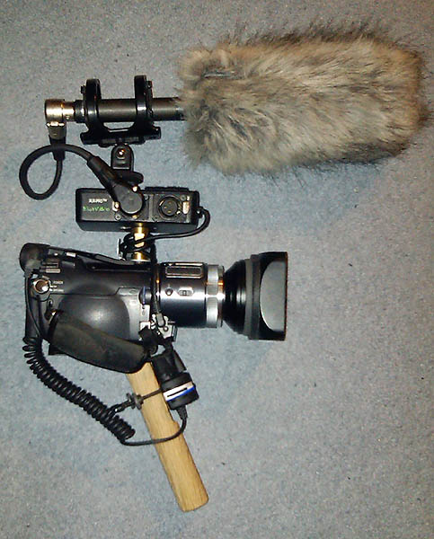

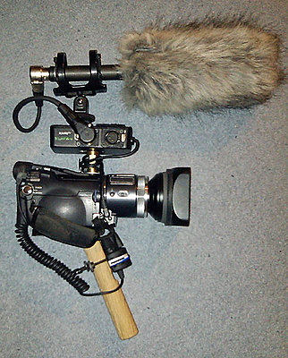

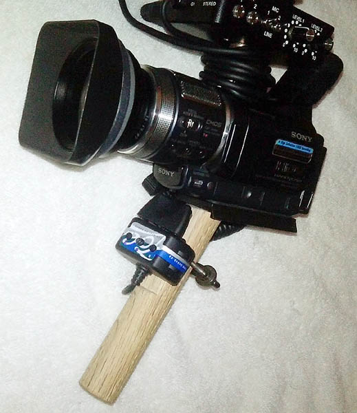

I really dislike the "grip around the camcorder" approach they have forced upon us. I used to use a pistol grip with my still camera and decided to make one for my video camera. I made it quite simple. I cut off a wooden dowel, drilled a hole in the center and screwed in a thread insert like this Thread Inserts for Hard Wood by E-Z LOK . It takes a 1/4-20 bolt (the standard thread on camcorders and cameras). I screwed in a bolt, cut it off long enough to add a piece of glued cork around the bolt with enough thread left to go in camera. I have a Zoe LANC controller that controls zoom, push to focus if I want and record.
The one shown in the pictures is actually a 5/16 bolt that fits the larger inserts on big still lenses and in this case the plate that slides into my Gitzo fluid head also will take a 5/16 bolt. I use the plate on the camera and then attach the pistol grip to the plate because I carry quite a bit of weight on the camera. It is easier for me to hold at an angle so I cut one end of the dowel at an angle and put the insert there.

A left-hander camcorder?-hc1_grip1.jpg   A left-hander camcorder?-hc1_grip2.jpg
