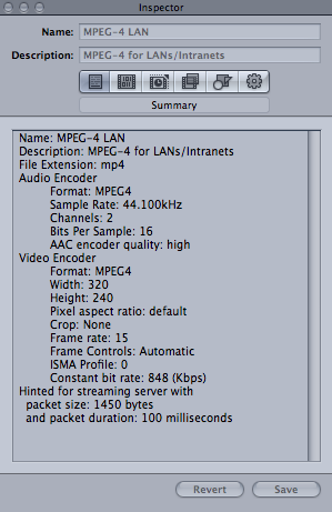

The thing about MPEG4 is that there are various ISMA profiles that affect the CODEC that is used. I've had sync problems in the past on long clips. Attached is a screen shot one of the Apple Presets from Compressor that you may want to try or at least start with (if you didn't already).
Also, if you mistakenly set it to add streaming information, you don't need that. It's for streaming server use.
