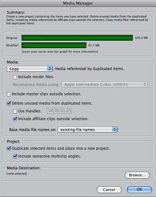

Hi Jarrod.
I think editing in DV format is the best format for this job. You could edit one DVD at a time then use media manager to duplicate or move your project excluding footage left out of the edit thus keeping the files size down. (see attachment). - Note FCP
Alternatively if you are on a fast Mac you could encode and edit in H.264. This would give you equal if not smaller files than the .m2v.
If you are colour grading the footage and adding effects then H.264 is not the best option, I would stick to DV.
If you are going back to DVD then there will be no problem fitting back to disk once encoded back to Mpeg-2. If you do not require DVDs keep in the H.264 or generic Mpeg-4 with .mp4 extension, handy for PC friends or family.
James
