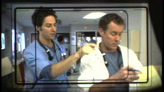

I would say that the rule of thirds is pretty much the same between a 4:3 and 16:9 frame--obviously the thirds are just further apart for 1:78. It's one of those basic sort of compositional guidelines that becomes instinctual.
For something like 10 years now we have been wrestling with dual framing for episodic television, we used to frame for 4:3 and protect 16:9 (making sure there wasn't any junk on the sides of the frame) and now it's generally frame for 16:9 but keep the important information in 4:3, which is even more confusing. Some shows ignore 4:3 entirely, which is a blessing. It's been a real pain. Attached is a frame grab from an old episode of "Scrubs" where you can see all the different markers that I had to keep track of at any time.
